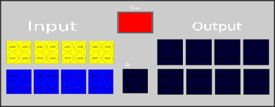

AJB2K3 Posted yesterday at 10:31 AM Posted yesterday at 10:31 AM I've always wanted a virtual interface b like the old software so started work on one. Quote
