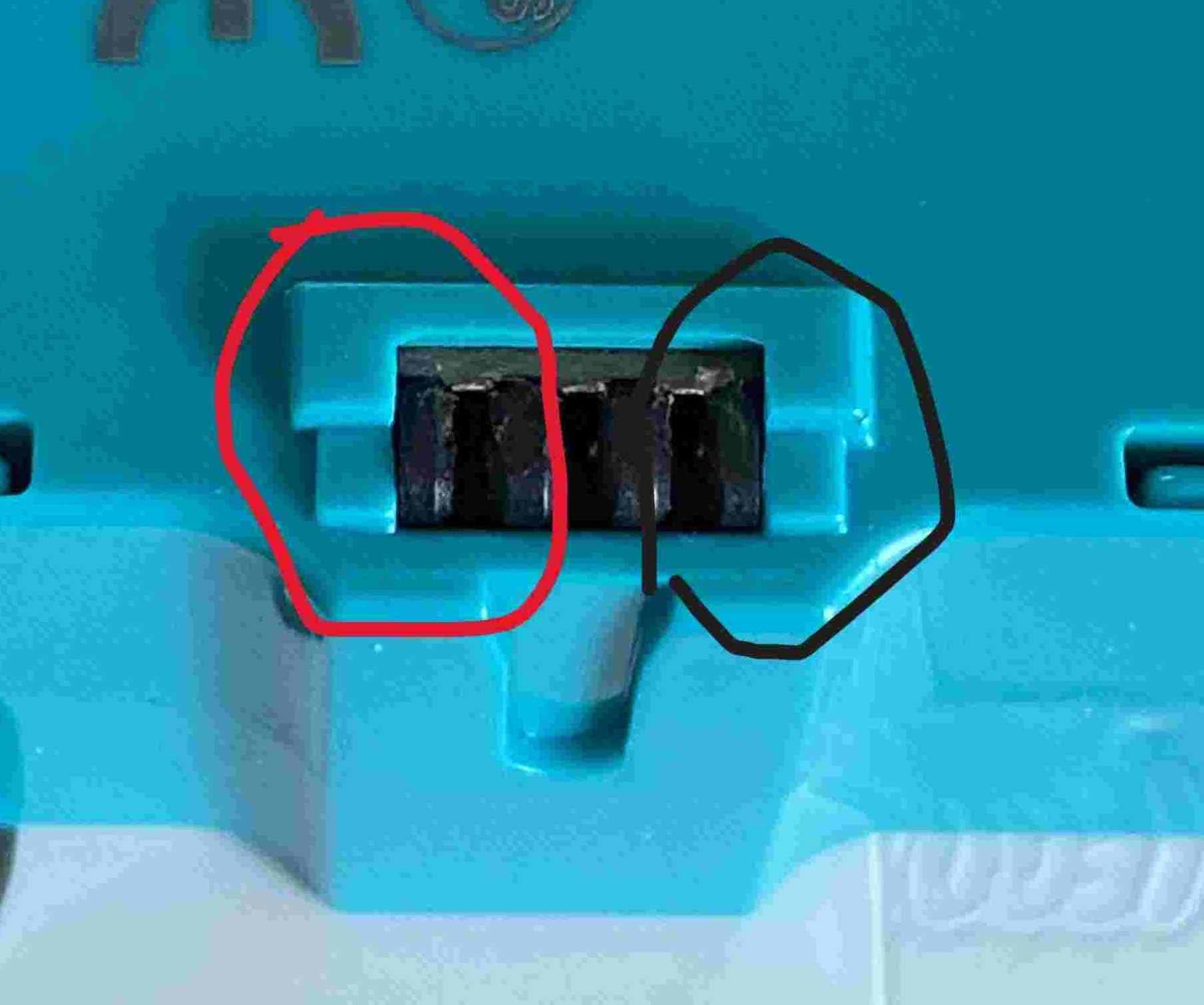

jazzlover Posted August 8, 2024 Author Posted August 8, 2024 So you use the two outer terminals (there are three). The red is the positive terminal and black the negative. I used a Maplin bench power supply to do this as you can accurately set the voltage and slowly increase the current. They don't make it anymore but this one would do the same thing:https://uk.farnell.com/duratool/d03232/power-supply-1ch-15v-2a-adjustable/dp/4161317?gross_price=true&CMP=KNC-GUK-GEN-SHOPPING-PMAX-High_ROAS&gad_source=1&gclid=CjwKCAjw2dG1BhB4EiwA998cqI6CJbfW7mUCw16kGo9AqKvzNMuYh1U4KLI5m2oUnn32WfBeKRlW9RoC_fkQAvD_BwE Quote

jazzlover Posted August 8, 2024 Author Posted August 8, 2024 Hi, the advantage of using a bench power supply is that you can set the voltage and then separately increase the current. If the battery wont take any current then I'm not sure it can be fixed, but I found that initially it took zero current and as I increased the current on the power supply it suddenly started showing current flow. Once that happened then the battery started charging in the hub. Also you have to press quite hard on the terminals to get a good connection. Interesting about the polarity though. I initially connected a voltmeter to a good Hub battery to check the voltage and with the positive lead connected to the one I highlighted in red I got a positive reading of 7.4V, so when I connected the power supply to the faulty battery I again connected the positive supply to same terminal. Quote
