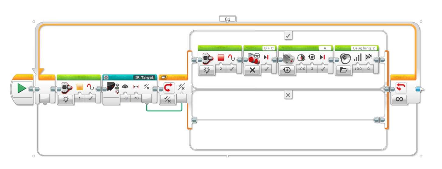

Here is the code supplied in EV3 Home:
It's also possible that there is an error in IR Target code: maybe LEGO made some changes to brick firmware or/and EV3 Home app and forgot to check default programs, which are provided in EV3 Home.

I’ve connected EV3 brick to my PC via USB for debugging - IR sensor works as it should - i see correct readings (distance and heading) when IR beacon is ON. So, something is wrong in IR Target - it’s a special block, which includes some math under the hood.
