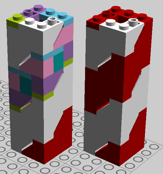

One simple option that occurs to me would be something like this:
ALs6j_HDhwqXCxf1RHq0LUZSLKyfcvUWYmz5DvBz-5FIdS_chbiD58zdrBYJvCi64VeF0BX4oirUo9uczA0bDSpRKXDpL-lIwQYFe36mzxrW-Xr4m9CEouOg7h0hZGKbus9pj-aKHwnhS5ffIn3kfYC607M3zmUFG_szmeozxBbR81qpBqBUVc-Luk8_A_oTyU-eEMFchNSt5fF7JGuel3gpNKjJloRuC47zN0PyoHLremb6VycoNPUobsU0LfDpeS2E7hkwoxsSFo8UD76tXwFYxvL8EICwGl1Y1AYnNdbAv34MDd6zFxwbnm1R_i2CChmT13okfJj4hl9urKCipIYAtOrxM_GhAxVUM3uiWELzO_0qspFkStow97KHQrCGY3_NRMhB7ztrSWel9aHOCJCJD_Ei4u7Cmgq0OCzpYBdIzxfqTpM8V9qLbOYECxv_xSxHqWitkWUQwTQ0V9lLob5JwVeEvNrERcViySEjiTYAiRfrxGS6QX0jEaJ9-SaUUR83XMLKWd14_iPLmS0Io1ucj5Sr74kNYIqznzZDrVkdE93KZ47Y1nya_UZ54-N2PfFZ_MkJN6r9ZLTOWo-nkoIpY-coYAiVcteTvdDiFzigTsgCY3K01kwTje0TA92wwVZdK9oxM1--6KtNFGTYYVdEyfWxtgNTCxd0hyT1H0dwgQuwXmF9Ah2AFsoiBq3_kfPvgGGUN9ntcgeghlDxnFr7XTK28t0ySdC8CxHeYsX8w6Y2SuLHp5DSP3d35f4z6MJ6V2qSMgaNkWDrgXnP0UbN5NQvYiM1XbOwVexcKeR3dTWT1_J69zKnTkHnjNPiaGO4LruPu5_PNl7MtnyBpjyZmjocY4NTcgNqULc6p3YqiRzrkfDMLQzfd8VB5KntE7w42aGhPtztbKTuLYDznU13xO_TWg4KPnrHEgwICdNtkpcNa4Ja4xKifZpzgrvD-wmRczSqrx8GNSATzuwNHE6N9ggdvIqcGgZJ7mGmp63IQOdzVOwjKzY2SJEnOazhCfqQ-mMCipgXIH9xrdhXMdIv5qC5eBuZ55bs9xtp0i3WGshnDYyGpNXhhZQ7hK7aXXiV_7sIj28F6tyct17nYEgeX45hhMFzQ35sgYeRUl4TxK673Uvr9ywtTi_BAK91yQjdEpyV04LCslsidxtmp8Ct90Z-iFUnxuNkuGu--vn7CYp1Oc6vBYHFvgjD_eWV_4fwTJOXH_4Hn9r18B10o9xho5yj1UQeyz5mAHsqHduEpiBS6QqpKTqiaNYNcqbOdHPVdJdnA5aaRxyz0PLXqm87YcWn_PN9ZYaY-5UdI5-KZTAaBCbSje_dmnuSqwtLMoqUEmhvsProuk4ah6jKi6USGSpqPwVXU0kptOsi6dX-1bKqXbutpmeu6GZ7QT0-ZZIOIsH-_RNWHceJ6U0NP72BXIwAh6UQs60VkP7eGDY4l1YwZRnHD1OhIzmhETrhnOgiIMNmiS1un7AxOMTjQqWvdhlSwiOeK7r3tL5o4GC95GULgvu19t7QOfbp3rz4tC6NCf4je0pGJYLBfK9YE8j32wEnEYBr2n5SlRNUIPBbtwVKA410IGKJZVGOVxRv3FdHyijvJVWSOeHE-_j-6_T0I9BkQfmvnYrwl3oj6aa1S93iwMV5HBQOrg
Each layer is made up of two of part 67329 and eight of part 35787, evenly split between the two stripe colors of your choice. The resulting pole should hopefully be wide enough to support a light brick towards the top like what you're envisioning.
The main drawback of this build is that there's no room to run a bar or Technic axle through the center for added support. But if this is for a static display that shouldn't be a major problem, as long as you don't make it too precariously tall!
The vintage macaroni bricks can be offset, unlike modern ones. So you could use those to create a 4x4 circular cross section cane. Plus it would have an open core to run cables through.
Keeping to simple parts you could try:
Left image showing part usage.
It's pretty sturdy and has room down the centre for a spine/cables/reinforcing the sides
