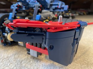

First the rear lights which I have already started on (see pic.- the bottom inner section should be red also just dont have that color). I am trying to get the led line to be as thin as possible so for the outer light section I used the small technic panel fairings 21 and 22 upside down, and for the inner ones to get the right angle- fairings 7 and 8 and then 2 and a half bricks space before the red tooth piece held on the end, and a bendable tube around the top. If there was a better piece to fill the 2.5 gap and get a smooth transition between the blue (supposed to be red) faring and the tooth that would help alot. Another thing on the back that is going to be tricky is the diffuser shape, im trying to work that out.
