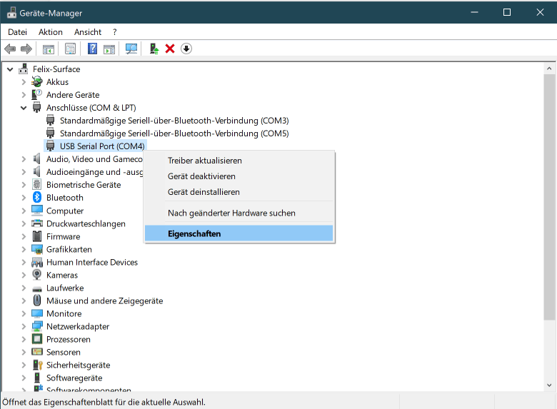

Azrael1706 Posted November 10, 2023 Posted November 10, 2023 Hello, I hope there is someone out there to help me. I recently dug out my old cybermaster set and tried to make it work. I wanted to show my son (5 years old) the fantastic world of Lego Cybermaster. So I set up a VM (VirtualBox) with windows XP and installed the Cybermaster software there. Everything's runnung greatly. (If someone is interested I'd love to share the setup process). I can start the software and get a connection in game between the tower unit and the mobile unit. I connected the Tower Unit through a Serial-USB Connector with the PC (its a windows surface 4pro by the way). It takes some time to connect, but it always will (I assume it's due to the VM). In Game I can controll the Mobile unit directly with arrow keys and the additional motor with CTRL and ALT. No Problem. My Son and I having already a great time with the set. So it was already worth it. PROBLEM: I cannot download a Program (Code) to the mobile unit. When I try, the Tower starts flickering as well as the mobile unit, but after a few seconds the mobile unit just turns off. No Programm downloaded. I also installde Bricx Command Center directly in Windows 10. Here the connection starts immediately. I, again, have direct control via the "Brick Joystick" Tool and the "Direct Control" Tool. I cann also play music notes through the "Brick Piano". But still I cannot download code to the Mobile Unit. I can write code and compile ist successfully, but the download always crashes. I own three Mobile units (and Towers) now for testing. All show the same behavior. I assume it's got something to do with the Serial Connector. Maybe the Read and Writing timings are off. But i have no idea what to change them to. I hope someone here can help me. I'd really love to show my son how we can program the robot to do what we want. Thank you very much. Quote

Azrael1706 Posted November 10, 2023 Author Posted November 10, 2023 (edited) On 11/10/2023 at 1:08 PM, JaBaCaDaBra said: Did you assign a com port to the usb you use? Expand Yes I did. It’s on com port 4. On 11/10/2023 at 9:31 PM, Toastie said: I believe yes, otherwise direct control won't work? If of any help, I'll fire up my cybermaster units and try downloading a short program. Direct control worked flawlessly also here ... Expand That’s sounds great. Do you use a usb-serial adapter as well? Maybe I could copy your settings if they work. On 11/10/2023 at 9:31 PM, Toastie said: Now, you are of course aware of the 396 LEGO byte code RAM limit, right? Best, Thorsten Expand Oh yes 😂 I am well aware of that. I used to program the brick about 10 years ago. It was a lot of fun for me. Got it driving around wildly, while playing a little song. That’s all I‘ll ask of it. Edited November 11, 2023 by Azrael1706 Orthography Quote

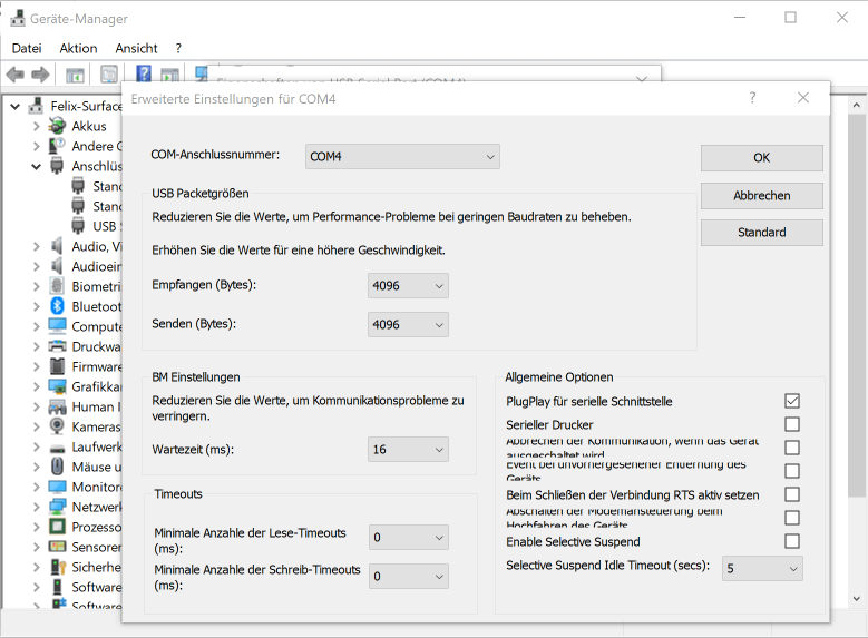

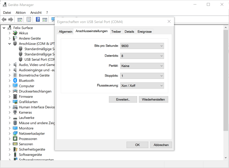

Toastie Posted November 12, 2023 Posted November 12, 2023 (edited) On 11/12/2023 at 11:05 AM, Azrael1706 said: No change. :-( Expand Oh crap ... all "advanced" serial ports settings are identical. However, I noticed that you are using XON/XOFF as protocol; I have "none" activated. The IR/RF towers are as dumb as a rock. They don't know anything about flow control other than having the bridge between RTS and CTS = "always ready". BricxCC/NQC don't even bother, the LEGO software does though - the SCOUT tool for example claims there is no tower when the corresponding pin is not pulled high. The electronics in the tower is naturally always way faster than 9600 baud can ever be - it doesn't have to do anything other than emitting the IR/RF serial signal coming in and vice versa. Not the point. But when you have xon/xoff activated, any "tower echo" or CM reply with value 0x13 may stop the transmission, as this is the character to signal "device is busy". For ASCII character transmission, all is fine, as these begin at 0x20 (space). All characters below (0x00 - 0x1F = 32) are considered control codes. LEGO byte codes are of binary nature - no control chars at all. That may be an issue when transmitting longer sequences of bytes (a program). And then no further bytes are coming in, as the towers don't do anything smart, as for example sending 0x11 = "ready" ... I'm not sure though, you can simply try that out - somewhere in your code may be 0x13 ;) Best regards, Thorsten P.S.: I just noticed the pwr command is byte code 0x13. Mayb you should just let the CM brick play a tone. Does this work? Edited November 12, 2023 by Toastie Quote
Azrael1706 Posted November 13, 2023 Author Posted November 13, 2023 On 11/12/2023 at 1:08 PM, Toastie said: Oh crap ... all "advanced" serial ports settings are identical. However, I noticed that you are using XON/XOFF as protocol; I have "none" activated. Expand Hey man, thnaks for that. I really thought that's the problem. I changed the vallue to "none". It didn't do any change. Cannot download any Program to the brick, neither via BricxCC nor via the original Lego Software (Cybermaster). Still the same behavior as discriped above. I even tried a Code that's got only a comment, not even a line of executable code. Same result. I am out of ideas, now. Still appreciate any suggestions you guys might have. Quote
