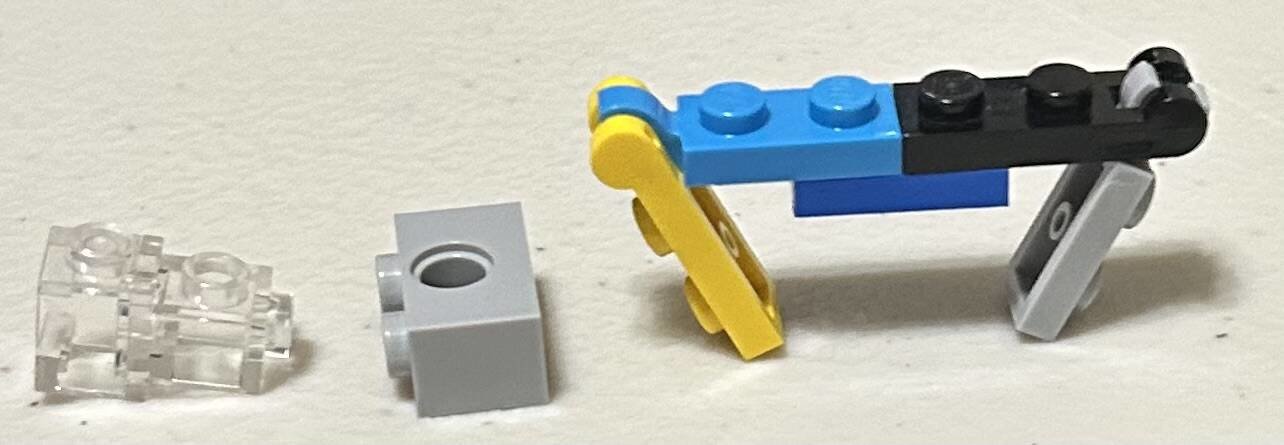

How small a space are we talking about here?  Can you give an example- photo / illustration of where you need the 2.5 plates so we can see what there is to work with?
There are some potential options depending on the available space under and adjacent to the spot in question.  For instance, if there's room to work with to secure them, a brick is 2.5 plates wide and some brackets are 2.5 plates in one dimension, so if you can place either of those elements with the side stud facing up you end up with a flush, no-gaps stud facing in the same plane at 2.5 plates high.
IMG_8401.thumb.jpg.af85dcd3b7e7ca04b316b21fc5414d9e.jpgI’m looking to work in a 1x4 plate space with 4 LEGO units of depth shift max in either direction. Headlights produces one 2.5 plate connection, but also a 3 plate connection right beside. A brick with technic pin holes would also work if one side were studs instead of holes. Hope this helps.
