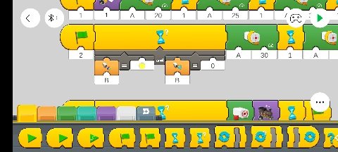

I've attached a basic example of my code.

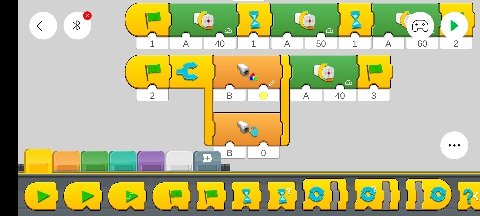

Thanks so much, your idea worked perfectly and I have a far better understanding of the app now.
I've attached a screenshot of it's of help to anyone else.
