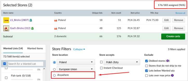

Easy enough to see - while you are at the right screen, and for a single store at a time.
Look to the left of the screenshot here - make sure you are on the 'Wanted Items' tab at top. Now when you select a store, you will see the item counts '0/1', '10 of 20' etc. You can also click the locks to filter to stores that must have this piece and so on.

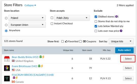

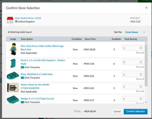

Whenever you have missing lots, it's likely because the stores in your country don't have those item
So to check what those items are, just switch to searching to anywhere, as stores around the world are likely to have those missing items.
Just select one of the shops that has the items, and you will see the ones that you are missing!
