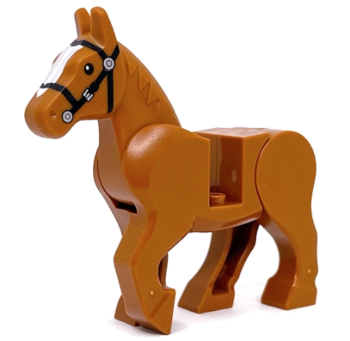

mvLego Posted October 9, 2022 Posted October 9, 2022 (edited) Does anyone know if it's possible to change the positioning of the movable horse in Stud.io? I'd like to have it rearing up, but it doesn't look possible from what I can see. Any help appreciated! edit: I forgot to use a question mark in the title Edited October 10, 2022 by mvLego Quote

mvLego Posted November 4, 2022 Author Posted November 4, 2022 Thank you! Unfortunately, the program doesn't want to treat the horse assembly as individual pieces/parts (at least not that I can see). Is there a way to break it up into the different components? Quote

Berthil Posted December 13, 2022 Posted December 13, 2022 (edited) No answer from the topic poster. I suspect the new horse with 'posable' back legs is meant here. In general, these are treated as one part in Stud.io and individual parts can't be moved, e.g. all movable pneumatic components and 3L Technic joints. To be able to move individual parts these need to build up in Stud.io from their individual components. If the individual components are not available as official parts, most likely they are available in LDraw library. In the case of the horse they are. Download all .dat files (and their related files) and put them in the right location in your Stud.io folder and restart Stud.io, they should appear as Custom parts. If not, try opening the .dat files in Parts Designer and 'publish' to Stud.io from there. Note that custom parts are not transferred to Bricklink wanted lists on export, in the case of the horse it should be added manually to an exported wanted list. Edited December 13, 2022 by Berthil added wanted list remark and horse image Quote
mvLego Posted December 14, 2022 Author Posted December 14, 2022 On 11/21/2022 at 3:45 PM, Jdrewg said: Is it a submodel? (Similar to the hinge) Unfortunately, no. 15 hours ago, Berthil said: No answer from the topic poster. I suspect the new horse with 'posable' back legs is meant here. Yes, I was referring to the poseable horse. Studio refers to it as "movable" but I agree that poseable is a better description. 15 hours ago, Berthil said: To be able to move individual parts these need to build up in Stud.io from their individual components. If the individual components are not available as official parts, most likely they are available in LDraw library. In the case of the horse they are. Download all .dat files (and their related files) and put them in the right location in your Stud.io folder and restart Stud.io, they should appear as Custom parts. If not, try opening the .dat files in Parts Designer and 'publish' to Stud.io from there. Thank you! I had no idea about the custom parts. I'll look into setting the correct pivot points later, but I was able to add the parts to Studio for now. Relevant helpful links for future folks: Link to all poseable horse parts Adding custom parts to Sud.io (Windows) One note: one last step after creating the "CustomParts" folder: add a "parts" folder inside the CustomParts folder. Quote
