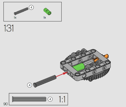

merman Posted November 26, 2021 Posted November 26, 2021 See step 131 of the first booklet. There is no way you can get this axle out!!! Quote

merman Posted November 26, 2021 Author Posted November 26, 2021 Sorry could not post pictures here. I take my models apart after a while and this is a huge building error. Quote
Jerac Posted November 26, 2021 Posted November 26, 2021 This most likely is a designer's error which has been missed by the QA team. There is no way to legally disassemble this. Quote
Kage Goomba Posted November 26, 2021 Posted November 26, 2021 Then don't include the green pipe - if its that big of a deal to you to being able to disassemble. Quote
merman Posted November 26, 2021 Author Posted November 26, 2021 (edited) Good suggestion! And you can be all lightly about it but this is a €800 set and I don’t think many people will realize you cannot take it apart if you follow the instructions Edited November 26, 2021 by merman Quote

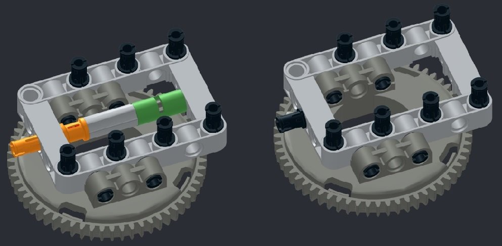

1340cc Posted November 26, 2021 Posted November 26, 2021 Looks like the axles don't do anything (aside from preventing disassembly that is) so I'll just swap them out for a standard black pin on the outside of the rectangle. Quote

1340cc Posted November 26, 2021 Posted November 26, 2021 On 11/26/2021 at 10:28 AM, Kage Goomba said: Or not use the green pipe saving you the trouble of using other parts? Expand If you do that, the orange pin could be pushed inside the rectangle when you attach the 1x2 liftarms at steps 171 & 220, which can't happen with a regular black pin on the outside. Quote

1340cc Posted November 26, 2021 Posted November 26, 2021 On 11/26/2021 at 10:57 AM, Brikkyy13 said: A lot of the people who had review copies definitely would have picked up on that being illegal. Expand This is the most surprising part. There must have been dozens of review copies sent out, and no-one said anything about it. At least I've now been warned before mine arrives. On 11/26/2021 at 10:57 AM, Brikkyy13 said: It's possible this was done on purpose for stability reasons Expand Only reason I can think of is when you lift the model, the axles might be to stop the weight of the legs from pulling down on the 4 black pins connecting the rectangle to the turntable? But the 1x2 liftarms attached on the outside would prevent them from falling off completely, and there's other ways they could have braced it internally which wouldn't prevent disassembly. Quote

Mr Ogel Posted November 26, 2021 Posted November 26, 2021 The orange pin is used to avoid that the pin is pulled out when you remove the leg from the body, maybe for transport or for other (strange) reasons. The black one would be pulled out and then you would have some kind of trouble to fix the leg again. I would propose to use a 2l liftarm instead of the grey Axle connector next to the green piece. The 2l liftarm 43857 can be attached to the turntable in step number 120, you need to replace the one black pin by famous blue one, 3l long and another black pin. In such way you would fix the orange pin. The green piece and the axle with stop would not be needed anymore. Maybe they did not find anybody to take it apart and to check feasibility - too much effort.... Quote
