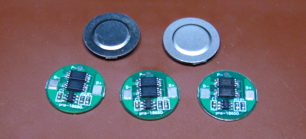

dr_spock Posted June 14, 2021 Posted June 14, 2021 Does the PU hub low voltage detection cut off the power when the Li-Ion cell falls below 3.2 volts? Quote
Wabbajack Posted June 14, 2021 Posted June 14, 2021 (edited) I did some tests long ago with two 18650 batteries, but had problems fitting it in my Maersk engine with the PU hub. My plan was to 3D print a custom bottom battery box that attaches the PU hub white top with electronics. This would have been a much better solution. Even if you have just a single 4,2 V battery with 3300 mAh and you double the voltage with a voltage regulator, you get 1650 mAh which compared to 900 mAh of Ikea Ladda batteries is a lot better, (and at higher voltage). Hmm, I think I will order some mt3608, and maybe even try to get a 21700 ... Edited June 14, 2021 by Wabbajack Quote
Toastie Posted June 14, 2021 Posted June 14, 2021 Nice one, Emanuele! Now with regard to @dr_spock's comment: Is this of concern? The mt3608 will hold the output constant as long as it can (which is excellent of course!). But will it do so even when the input voltage drops below the critical value of about 3V? Or is there some unvervoltage protection, as in all the devices running on LiPo/Li-Ion rechargeable batteries? If not, then you need to install such undervoltage protection circuit as well, as you won't notice too low volatges, because the output is always 9V - even with 2 V input. Which in turn may severely damage the batteries. Best Thorsten Quote
Wabbajack Posted June 14, 2021 Posted June 14, 2021 (edited) 10 minutes ago, Toastie said: Nice one, Emanuele! Now with regard to @dr_spock's comment: Is this of concern? The mt3608 will hold the output constant as long as it can (which is excellent of course!). But will it do so even when the input voltage drops below the critical value of about 3V? Or is there some unvervoltage protection, as in all the devices running on LiPo/Li-Ion rechargeable batteries? If not, then you need to install such undervoltage protection circuit as well, as you won't notice too low volatges, because the output is always 9V - even with 2 V input. Which in turn may severely damage the batteries. Best Thorsten Li-Ion are very sensitive to low discharge (not sure about LiPo, but its better to be safe than sorry) and it is strongly recommended to use a battery protection circuit between the battery and the regulator. I think a battery charging circuit with these protections built-in would be perfect. Edited June 14, 2021 by Wabbajack Grammar Quote
Toastie Posted June 14, 2021 Posted June 14, 2021 (edited) 1 hour ago, dr_spock said: Does the PU hub low voltage detection cut off the power when the Li-Ion cell falls below 3.2 volts? Don't know - but don't think so - with LEGO devices running on LiPos (there are only very few, I believe) this circuit is usually built into the "battery pack" replacing the batteries or the compartment, isn't it? At least the NXT LiPo battery had that protection built into the battery pack but there is no such circuitry in the NXT. Nor RCX, etc. pp. 8878 certainly had that - but that is just a battery pack ... I believe you need to tell the hub that you are using a rechargeable battery set, which may explode when running below a certain level. OK, maybe not explode, but calling it quits . Wasn't there a mirco switch thing in the Technic hub? Don't remember. Also in case of @LEGO Train 12 Volts's solution, the hub would not know that the battery is operated below damage threshold, as the output is held constant as long as possible but the input not as long as healthy ;) Best Thorsten 11 minutes ago, Wabbajack said: Li-Ion are very sensitive to low discharge (not sure about LiPo, but its better to be safe than sorry) and it is strongly recommended to use a battery protection circuit between the battery and the regulator. LiPos are as well a bit diva-ish - at least when it comes to operating range. They also do tend to go into flames when not treated as such. TLGs answer to all these challenges was the 8878 LiPo box: Input: Charging while operating, wide charging range, overload protection. Output: Overcurrent protection, under-voltage protection (9V/0), on/off switch (9V/0), adjustable output (C1/C2) ... Too expensive and ... retired. For whatever reason. Maybe LiPos are too much for a toy company. Best Thorsten Edited June 14, 2021 by Toastie Quote
Wabbajack Posted June 14, 2021 Posted June 14, 2021 (edited) 16 minutes ago, Toastie said: Don't know - but don't think so - with LEGO devices running on LiPos (there are only very few, I believe) this circuit is usually built into the "battery pack" replacing the batteries or the compartment, isn't it? At least the NXT LiPo battery had that protection built into the battery pack but there is no such circuitry in the NXT. Nor RCX, etc. pp. 8878 certainly had that - but that is just a battery pack ... I believe you need to tell the hub that you are using a rechargeable battery set, which may explode when running below a certain level. OK, maybe not explode, but calling it quits . Wasn't there a mirco switch thing in the Technic hub? Don't remember. Also in case of @LEGO Train 12 Volts's solution, the hub would not know that the battery is operated below damage threshold, as the output is held constant as long as possible but the inout not as long as healthy ;) Best Thorsten Yes, but if you connect a Li-Ion battery to a charging board, for example one with TP4056 and connect the regulator to its output, you will have overcharge and overdischarge protection. The regulator will keep the Hub at 9V, so it will think the battery is always full. The charging board however will simply stop outputting power once battery voltage drops too low. Best regard, Martin Edited June 14, 2021 by Wabbajack Changed link to a better source Quote
Toastie Posted June 14, 2021 Posted June 14, 2021 (edited) 5 minutes ago, Wabbajack said: The charging board however will simply stop outputting power once battery voltage drops too low. Oh yes, that is what I was aiming for, Martin! I just don't know, what mt3608 has in its brain ;) So let's do the math: mt3608 + tp4056 = 8878? Best Thorsten Edited June 14, 2021 by Toastie Quote
Wabbajack Posted June 14, 2021 Posted June 14, 2021 1 minute ago, Toastie said: Oh yes, that is what I was aiming for, Martin! I just don't know, what mt3608 has in its brain ;) So let's do the math: mt3608 + tp4056 = 8878? Best Thorsten Also I used tp4056 as an example for Li-Ion, but it seem it can be also used with LiPo. I have done a little googling, but am not sure. Maybe someone can help? I think the equation mt3608 + tp4056 = 8878 is true, but I think the charging circuit was in the wall adapter 45517. You can use the charging circuit with tp4056 to charge with USB, so maybe mt3608 + tp4056 >= 8878. Martin Quote
dr_spock Posted June 14, 2021 Posted June 14, 2021 35 minutes ago, Toastie said: Don't know - but don't think so - with LEGO devices running on LiPos (there are only very few, I believe) this circuit is usually built into the "battery pack" replacing the batteries or the compartment, isn't it? At least the NXT LiPo battery had that protection built into the battery pack but there is no such circuitry in the NXT. Nor RCX, etc. pp. 8878 certainly had that - but that is just a battery pack ... I believe you need to tell the hub that you are using a rechargeable battery set, which may explode when running below a certain level. OK, maybe not explode, but calling it quits . Wasn't there a mirco switch thing in the Technic hub? Don't remember. Also in case of @LEGO Train 12 Volts's solution, the hub would not know that the battery is operated below damage threshold, as the output is held constant as long as possible but the input not as long as healthy ;) Best Thorsten My PU Hub blinks and stops working when my NiMH batteries fall below a certain level. I assume it'll do the same when the output from the step up converter drops to it. If it corresponds to 3.2V on the Li-Ion battery, then it is good. I bought some of these 18650 battery protection when I tried to salvage some from an old laptop battery pack. You shrink wrap them to the battery after wiring them up. They make the battery a bit taller too. Quote
Toastie Posted June 14, 2021 Posted June 14, 2021 4 hours ago, dr_spock said: I assume it'll do the same when the output from the step up converter drops to it. But the input voltage range of mt3608 is 2 - 20V - doesn't that mean it'll drown the battery to 2 V before it gives up? 4 hours ago, Wabbajack said: You can use the charging circuit with tp4056 to charge with USB, so maybe mt3608 + tp4056 >= 8878. Hmm. The charging voltage range of 8878 is (was) 9 - 18V, the power supply required is (was) a dead cheap unregulated wall wart. Spoiler However, with a 5V regulator as input, one could achieve the same or even better performance of 8878 so yes, your equation holds true! Most importantly: $/€(LiPo battery + mt3608 + tp4056 + 5V regulator) << $/€(8878)! Wow, I guess I need to order some stuff Thanks Emanuele and Martin!!! Best wishes, Thorsten Quote
LEGO Train 12 Volts Posted June 14, 2021 Author Posted June 14, 2021 6 hours ago, Toastie said: Oh yes, that is what I was aiming for, Martin! I just don't know, what mt3608 has in its brain ;) On the MT3608 datasheet that I found online, it says that the minimum operating input voltage is 2V and that the under voltage lockout is 1.98V. However, I installed this module in a casio calculator (3.7V -> 6V) and it stopped working when the battery voltage dropped to 3.2V. This needs further testing, but this first empirical test was successful. Quote
Wabbajack Posted June 15, 2021 Posted June 15, 2021 12 hours ago, LEGO Train 12 Volts said: On the MT3608 datasheet that I found online, it says that the minimum operating input voltage is 2V and that the under voltage lockout is 1.98V. However, I installed this module in a casio calculator (3.7V -> 6V) and it stopped working when the battery voltage dropped to 3.2V. This needs further testing, but this first empirical test was successful. That could be because Li-Ion batteries cut off at around 3.2V/3.3V (wiki link). 13 hours ago, Toastie said: Most importantly: $/€(LiPo battery + mt3608 + tp4056 + 5V regulator) << $/€(8878)! Wow, I guess I need to order some stuff Thanks Emanuele and Martin!!! You are welcome and I am glad to be of help. I already have the parts ordered and will hopefully show some prototype here soon. Martin Quote
