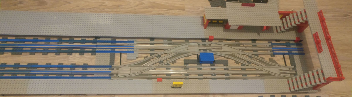

legotux Posted May 14, 2021 Author Posted May 14, 2021 (edited) On 5/14/2021 at 7:01 AM, SD100 said: My double HE with two motors in only the lead power car can ascend a 2 plate per track section grade no problem. I don't think I'd be able to stop and get going on it again but it's fine in motion. SD Expand Ah good to hear, thanks! But does that mean 3 motors total (one extra added in lead power car) or 2 motors total (motor moved from hind power car to front power car) ? My situation could be different because I drive on blue rails now, but still Legotux Edited May 14, 2021 by legotux afterthought Quote
