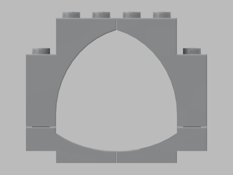

Lyichir Posted May 4, 2021 Posted May 4, 2021 70681 is designed, in many ways, as a mirror of the 1x6 arch 92950 (the same way that 18653 mirrors the 1x6x2 arch 15254). Like 92950, the curve of 70681 matches 1x2x2/3 "baby bows" (11477, or the inverted variant 24201). You can use this matching curve to create interesting curved patterns on a wall, or to create a curved surface that the bow bricks can slide along. 70681 also pairs really well with 13965—two of each creates a sort of triangular window shape with edges that bow outward. I was at first on board with your analysis, but you can't just critique all arches according to one use case (creating a smooth, unbroken curve with no corners) when there are many, many other purposes for arch bricks beyond that one goal. As mentioned above, gothic arches were largely impossible to create effectively before the introduction of 13695, so criticizing its curvature for not creating a full 90° curve feels like criticizing a square for not being round. I do agree, though, that the "step" in 30099 can be frustrating at times. Having studs at the bottom does have value in terms of connectivity, but leaves an unusual break in the curvature that isn't present in its non-inverted sibling. If you wanted to use those curves for windows in a MOC like you show above, I would recommend covering that gap with something ornamental like a gargoyle, planter box, or other sort of fixture to mask the "step". Quote
Aanchir Posted May 4, 2021 Posted May 4, 2021 (edited) I agree that smooth, quarter-circle or half-circle curves can be very useful, but I think there's still a lot of value to having curves that result in "corners", especially ones like 70681 that belong to a larger family of parts. Some of the other with the same "profile" as 70681 include 92950, 93273, 93604, 11477, 24201, 29119, 29120, 32803, 41854, 66956, 73682, 88930, the inside AND outside curves of 47755, the top and bottom of 35300, and the flat sides of 30602, 44675, and 62361. And there are probably others that I'm either forgetting or haven't discovered yet! Others have already mentioned examples of instances where it can be useful to have arches that AREN'T a perfectly smooth curve, such as gothic arches, but I should also add that 13965 and 70681 can be combined to create a beautiful approximation of a Reuleaux Triangle, with an opening 4 studs wide by 10 plates tall (32mm by 32mm): Edited May 4, 2021 by Aanchir Quote
