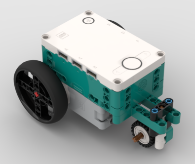

Roboteer Posted April 13, 2021 Posted April 13, 2021 (edited) I've been using Studio 2.0 to document a simple robot using the Robot Inventor 51515 set. Imported the parts as the "Robot Inventor Prime Lessons" suggest, that pretty much worked. My question is: Is it possible to group all the parts that exist in the RI 51515 set, separately from all the other zillion parts Lego has designed over the years? So that when I want to select, say, a 5-hole lift arm, I don't have to wade through every part in the universe, to find it? I've used Studio's Search function, which helps a little, cuts down the possible parts search to only one million parts to of the three zillion Lego has made. LDD used to group its parts for, say, the EV3 31313 set, and every time you used one, there was one fewer remaining. Can we do something like that in Studio 2.0? The simple robot after rendering: Hub, two drive motors, two large wheels, one small pivoting front wheel Edited April 13, 2021 by Roboteer Quote
