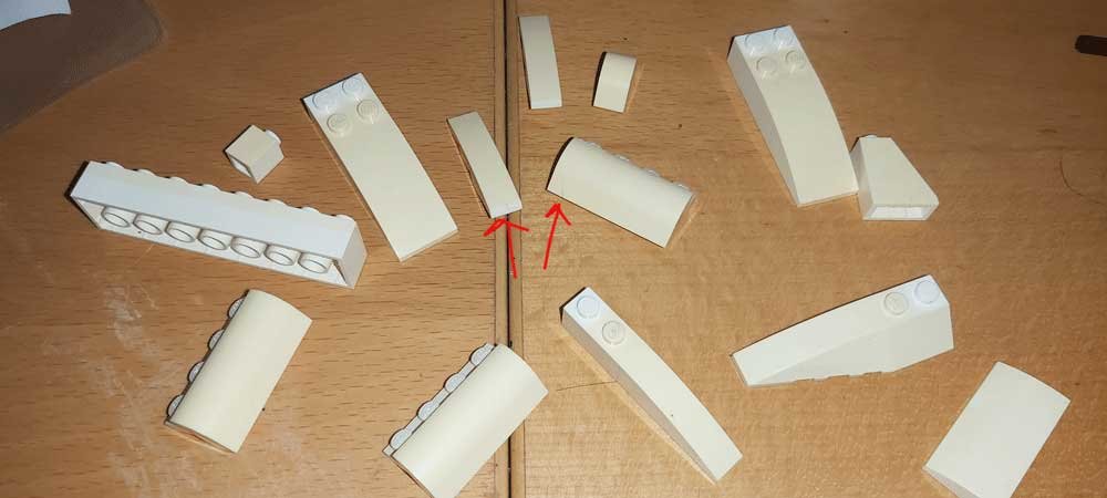

RNRS001 Posted March 6, 2021 Posted March 6, 2021 I'm sure much has been said about this issue but I've a question related to this. I see so many fantastic sets but I often wonder what they look like after a few years. Can anyone shed a bit of light on this? The reason I'm asking is this; About a year ago I contacted LEGO about the yellowed parts for my Volkswagen camper. The set had never been in direct sunlight and yet some parts just looked like a different colour altogether. Some showed cracks as well, as can be seen on the photo attached. The arrows point to cracks, this isn't just dirt or hairs. LEGO had send me all new white parts as even those hidden in the set itself were yellowed. Last year I moved to my new place and was able to get a LEGO-room. I've spend the past few weeks building pretty much every town set from 1980 to 1995 until I ran out of space. Once this was finished it was time for the "grown up" sets. I was able to put the Volkswagen Camper back together with the new parts from LEGO. While building I realized that the blue from the seats had turned grey while it'd been in a box for a good 3 months. I realized that with many of those newer sets I noticed cracks as well. The Unimog has cracks in the orange parts, the yellow big crane truck has broken parts... Putting everything back together from the eighties made me realize that some white parts from that era are not as yellow as the white parts from that Volkswagen Camper. I've about 5 broken pieces from that era as well. LEGO was just of better quality I think? I see the Lamborghini has colour issues... I really like LEGO but I've refrained from buying the Ghostbusters car because of issues like these. Hence me asking. White doesn't stay white. Blue doesn't stay blue. Grey turns green/grey... What do the big sets look like after just a few years? Quote
Alexandrina Posted March 6, 2021 Posted March 6, 2021 Parts don't seem to yellow at a consistent rate. I think exposure to sunlight has an effect - your photos show what I've also experienced, studs that are covered by over bricks tend not to discolour as much or as fast - but that's not entirely the case, and even within a set you can see the discolouration happening at different speeds. I have next to me set 75182, bought new in 2017 and assembled on the day of purchase, and having been on my shelf ever since. The parts are from the same box, have had the same exposure to daylight, and on some the yellowing is clearly beginning while other bricks are as bright white as when the set was first opened. Unfortunately yellowing is inevitable, since it's a property of the plastic itself; sooner or later, every white brick will turn yellow. There are posts on Eurobricks with suggestions for combating the yellowing - I can't vouch for these, since I've never tried anything myself, but it does appear to be possible to restore white bricks to their original colour. I'd guess that any part with a sticker on is impossible to salvage without removing the sticker in the process, but who knows? To be honest, if you're into Lego enough to have a Lego room, and you want the Ghostbusters car, I'd go for it. Certainly don't hold out in the hopes that Lego fix yellowing once and for all, because I can't see that happening any time soon! As for broken bricks: I've never broken a brick myself (except for a plant piece which I shut in a door hinge when I was younger!) but I've come across many from joblots. The broken parts have tended to be older bricks (1970s-1990s) rather than post-millennium bricks, with no correlating to colour, but I can't vouch for my anecdotal experience being gospel. Quote
koalayummies Posted March 6, 2021 Posted March 6, 2021 Its worth noting that fluorescent bulbs can emit ultraviolet radiation. So even in a blackout curtain room that gets zero sunlight but is lit by CFLs for example can be exposed to UV. Its interesting to see the contrast between the covered and uncovered parts of the bricks varying so significantly. Quote
