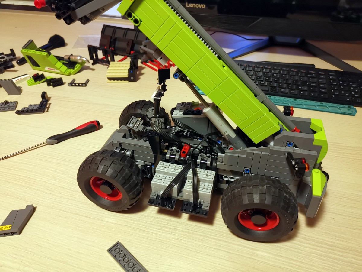

I started fiddling with the bracing for the arm extension worm gear, as with too much load on the fork the driveshaft will bow upwards and the worm gear will slip.  As part of doing this I realised that it was fairly straightforward to increase the extension of the arm to get an extra 4 studs of usable reach.
800x533.jpg.
Lift height is now 41cm which is bang on scale - 7m at 1:17.
I've also had some success with making the fork tilt more controllable by dropping the PWM frequency on the SBrick controlling the tilt motor.  This seems to give much more torque at lower speeds.
I am aware of this disadvantage. Your improvement looks interesting. Can you take a picture of the arm without the side cover?
The huge work you put into changing your model is a big compliment to me. I am glad that my work is so motivating for someone.
I see that I'm not the oy one using screwdriver with my MOCs during development (specially when one IR receiver stopped working :damn:; and completely new one from two weeks ago bought 42095 set)... Nice to see that original mastermind is happy with improvements of his own work :thumbup:
Thank you very much for the positive comments.  It is very hard to improve anything in this model - pretty much all my changes come with some compromise, so I understand the decisions you made to keep the design buildable, reliable and affordable.
I've actually just spent a few more happy hours modifying.  The play in the front steering from the bevel gears was annoying me so I decided to try something which I'd previously declared impossible:
This arrangement is much better than my previous effort.  As well as getting rid of the play, it gets rid of the unsightly servo below the cab.  I was concerned that removing the beams between the drive motor and servo would make the chassis too flexible, but the end result is actually very strong.
The only issue is losing the T pieces that brace the steering axles which means the gears slip if the servos force the steering against the stops.  Not an issue for use with SBrick/BuWizz as you can simply limit the servo travel electronically, but would be a problem for bang bang steering.  I had an "aha" moment when I realised why that bracing was needed.
As you can see, there's nothing holding the 4x2 beam except the side panel, and the 13L beam is only held by a single full pin at the rear.  I was doubtful about relying so much on the plates for structure, but it's proven completely reliable and very stiff.
Another tiny mod is just visible on the grey pin on the arm just in front of the light is a small elastic band holding the motor cable to the underside of the beam.  This solves the problem of the cable not feeding into the arm correctly which is more of an issue with the extended reach.
