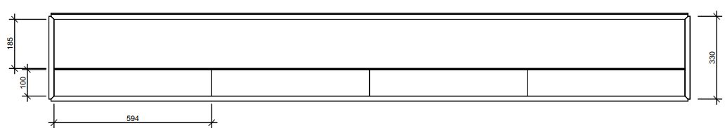

Well, it's not that much - yet, since the idea of not building a desk as I originally planned to for around a year came just last week, but here's a drawing of what the piece might look like.
The idea is to build a sideboard or lowboard, although I'm not sure if these terms mean in English what they do in German, as funny as that might sound our language has the habit to use English-sounding words that don't make sense. So basically, it's a long half open cabinet, rather small in height and depth since I want to emphasize it's length which should come in at around 240 cm or so - since I'm building in 8 wide, I want to have enough space to showcase more than just one or two locos at the same time, although my models aren't that huge yet. I think about four flap dours in the front, three of which include removable drawers with storage for curves, straights and switches, the last one being a place to store everything else that does not fall into one of the prior categories - I'll plan the drawers around the sizes of the individual parts, so they won't be much wider than a few pieces of tracks next to each other. The piece is supposed to be situated almost at ground level, since I doubt that I'll have a stationary layout I plan to use the piece as storage for the track, and every time I want to, I can take out the individual drawers and place the track on the ground. One detail I came up with after drawing this one was to include three or four massive feet made out of oak or beech in roughly the same size as sleepers of real rails, unfortunately german law makes it impossible to use real ones due to them being contaminated with pollutants (is that how you call that? Sounds wrong to me.), so I'll have to figure out a way of making the pieces look like the real deal.
The final thing I thought of so far would be a lighting system inside the open space, located inside the top parts bottom side, so it's hidden from sight. I looked up some systems that are used for model railroads that emulate day-night-cycles, and found one that can be programmed and controlled by using an Arduino - I have no experience with that kinda stuff, so I might stick to a different system, but I think it would be a nice touch that pays hommage to model railroads instead of being simple lighting that highlights the trains.
That's pretty much it so far, still thinking about color and surface materials although it will most likely be black with a clear coat, with the panels that have the milled in radii (located in the open space in the middle, above the flap doors and on top of the piece) in white to reflect the lighting.

Just one warning, do not count on being able to fit everything in there at once. Curves and switches take up way more space than straight track. At some point BrickTracks or TrixBrix will come out with a piece of track that does not fit your storage, etc. And of course as you build more you will find you have more and more favorite locomotives. But it totally makes sense to have enough room to store the track for a "good layout" allowing for quick set up and tear down.
