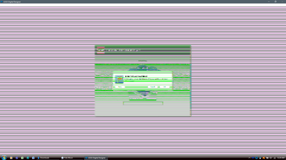

BrokenEye Posted October 29, 2020 Posted October 29, 2020 So I recently got a new computer, which necessitated upgrading to Windows 10. I was able to find workarounds for most of the annoyances that caused (as evidenced by the Windows 7 style taskbar in the image below), but when I installed LDD and tried to launch it, it came out looking like this: Crazy scanlines all over the place, and an error message I can't read. You can't really tell in this picture, because it's been shrunk, but each line is only about one pixel in width, they're just grouped together real close in places. The lines stay there when I actually open the build editor. They seem to be in a fixed pattern rather than appearing randomly or moving around. As far as I can tell, the program seems to function more or less normally, but I can't see 90% of what's happening on the screen. I can't even tell if the font is displaying normally or not. I've already tried reinstalling it and repairing the installation, but the problem persists. What is happening, and how do I fix it? Quote
Calabar Posted October 29, 2020 Posted October 29, 2020 If you tried to install LDD on a clean system too, that should exclude that the problem is due to the modifies you tried on Windows 10 to remove the "annoyances" (I suggest you to avoid this kind of practices on a main PC, they cause more problems than many people think). Anyway it seems to be a graphic card driver problem. What's your graphic card/IGP? Is the PC a notebook or a desktop one? Did you tried to install graphic drivers from the manufacturer's website after properly cleaning the pre-installed ones? Quote

BrokenEye Posted October 30, 2020 Author Posted October 30, 2020 Alright, I tried uninstalling all the Windows 10 fixes, and the problem didn't go away, though it does manifest slightly differently than it did before. Now hovering my mouse over an interface button causes the pattern of the lines to change until I stop hovering. Still green and obstructing everything, though. I'm gonna need a new solution. Quote

BrokenEye Posted November 2, 2020 Author Posted November 2, 2020 Alright, forcing it to use the Intel card didn't work, but forcing it to use the NVIDIA card did. Thanks for your help. Quote
Calabar Posted November 3, 2020 Posted November 3, 2020 You are welcome. So it seems a problem due to the Intel graphic driver. Nothing so strange really! Quote
