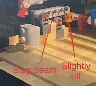

Ok, I am building the set right now but ever since the testing steps in the in instructions I’ve been having trouble making the thing work properly.
i guess the orange beam (see picture) should be perfectly horizontal or vertical but it hardly ever isn’t. There always seems to be a tooth off of the 24t gear. When I try to fix this by adjusting the gear there seems to arise another problem. There is a calibration button in the app but that doesn’t fix the issue either.
thing is: calibration works but as soon as I lift the grey stop beam, the orange beam is off one tooth.
Result: the long axle making the keys move won’t rotate when I play a song.
also: the smarthub keeps on lighting up in orange and blue.
who can help?

I know this is a late reply but I got this set and for anyone reading this, the stop beam would work only in reverse (anti-clockwise) -- that is when you hit the reset gear button in the Power Up phone app.  This will reset the piano keys to normal 'rest' position.
I doubt it will be fully aligned or perfectly perpendicular during normal playback.
As for your solution. Anyone new to this new smarthub, it is always a good idea to have fresh batteries. I had to buy new sets of rechargeable batteries just for this so that I do not have to worry about disposable batteries randomly dying.

I'm hoping someone can help me,.I have a similar issue as @merman with the 21333, the long axle worked both ways when I tested it, until I fixed it all together. Now the little orange beam stops against the grey stop beam resulting in a beep from the battery pack (when turning counter-clockwise) it only works in the clockwise rotation. I've double checked everything and can't find anything wrong with the build. Anyone else had this issue?
