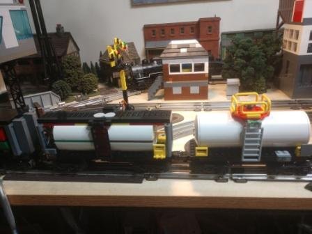

Charles Christy Posted July 31, 2020 Author Posted July 31, 2020 Here are a few pix of cars I've built. The first couple on standard double axle trucks are on Lego train plates, with Lionel truck assemblies underneath held by screws and using the holes in the Lego plates. The engine is a Lion chief Plus NW2 diesel so I get all the sounds, smoke, whatnot, that Lionel puts in their locomotives, real smooth low speed performer as well. The best feature of this system to me is that once you have a fleet of usable chassis, you can create or recreate whatever you want as opposed to having to purchase an endless stream of new stock. I didn't make any of these to be particularly 'prototypes' just interpretations of what you might see. Like the whole Lego RR system I think half the fun is to always be a work in progress. I'd put up a few more but there seems to be a limit, so more when I can, single axle Euro style Era II or III short goods wagons. Thanks for the interest! Quote
zephyr1934 Posted August 1, 2020 Posted August 1, 2020 Looking good. 18 hours ago, Charles Christy said: I'd put up a few more but there seems to be a limit, so more when I can, single axle Euro style Era II or III short goods wagons. Thanks for the interest! Oh, yeah, Eurobricks is not meant to store your photos. Almost all of the photos you see in this board are hosted elsewhere (flickr, brickshelf, imgur, etc) and included by links Quote
