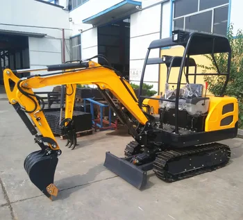

Unless the middle cab bar is integral to support, I'd dump it. It looks too much like a jail.
:laugh: It's not integral, I put it there to make it look like a grille-protected cab to hide the fact there's no windscreen. But here you go:
@LEGO Train 12 Volts@Jerry McGlade & @zephyr1934 - thank you! I feel its full of holes (quite literally with the technic boom), but I'm glad you like it. I'll draw a diagram to illustrate the string paths, since the boom will be very floppy without them!
I gotcha. I think a lot of smaller excavators lack a windshield though, so ditching it is likely okay in that regard:
