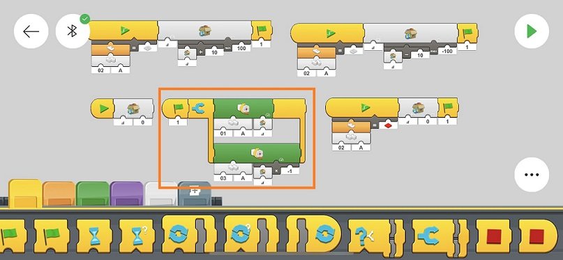

Dirch Posted July 25, 2020 Posted July 25, 2020 On 4/24/2020 at 11:17 PM, Elphiel said: Use the PoweredUp App and connect your Controller and hup to it. Then you can do exactly what you want without turning the motor, soldering anything and so on. Look into the Powered Up Thread. I created a PoweredUp app doing exactly this. Expand Danke schön Elphiel! The design created by Elphiel works. Got 2 x 60197 running controlled by my iPhone. I used a simplified version of the codingdesign to get the hang of it, but dont be discouraged by all the buttons and options in the app. To be more precise the description is on page 25 in this thread I started with just the stuff marked with a orange rectangel which send a start signal to both engines with a predefined speed ... and nothing more. The rest of the drawing is a more gracious start, stop and controllermanagement instead of the mobile phone etc. Quote
