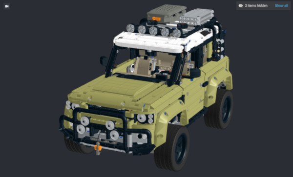

Tonyst4rk80 Posted February 17, 2020 Posted February 17, 2020 (edited) Hi I made a lot of changes for a while, I share with you : .io.file *Pimp up my Land Rover v1.2 *V6 engine *HOG shifting *Bull bars *Improved front lights *Front light bar *Tail ligth bar *Doors lock *Doors limiter *Body lift off *Coupling ball *Trailers Miss: Ackermann steering... I see that jb70 just updated, thanks I will post in real when I received all my parts... Thanks to : BrickWild Coolusername twoofive JunkstyleGio jb70 Pattspatt Leewan alademann BALBO85 Edited February 17, 2020 by Tonyst4rk80 Quote

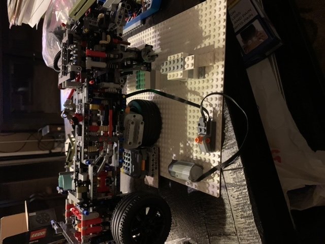

Windy Posted February 18, 2020 Posted February 18, 2020 Hi. I was hoping I could get some help. I am building the Land Rover set but the gears don’t seem to want to engage. I bought the power functions so I could run it and try to spot the problem but I just can’t tell what’s going on. I’ve taken it apart twice now and I currently have it so I can see all the gears but it isn’t helping. I contacted LEGO and they said I should watch build videos but what I really need is a schematic that shows me what should be moving. Can anyone help me? Quote

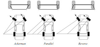

Urbal Posted February 18, 2020 Posted February 18, 2020 (edited) @jb70 Thanks for a quick reply on the body stiffness, sounds great! Now, I have modelled suggested Ackermann setup with available parts (and removal of one shock absorber on each , and it looked to me as Anti-Ackermann geometry used for racing cars, not offroad ones. Sorry if I'm saying nonsense, but to me it looks like that and steering is actually quite hard due to resistance of the outer wheel... Again, I would hate to add some noise, but appreciate if you could double check. Thanks! I've shared the photo of my PoC here Update: I believe anti (or reversed) Ackermann effect is there because of 1 stud offset is done into the wheel, not out. The latter is not possible though due to special Defender rims... Update2: I think the catch is that I put suggested geometry in the V1.2 setup with steering rack behind the front axle - apparently changing the axle positing and steering rods would change Anti- to just Ackermann :) Edited February 19, 2020 by Urbal Quote

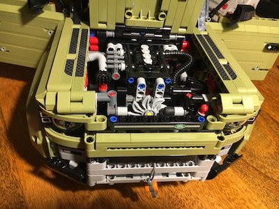

Edward011778 Posted February 20, 2020 Posted February 20, 2020 (edited) As others have done, I have substituted the silly original engine for a V6 using the standard Technic cylinders etc. Or at least, I will, I only have engine parts from a flat-4 currently. I've retained drive to/from the cabin steering wheel via a few chassis mods to give space to move the lower UJ further back to clear the rear N/S engine casing. Its tight but there's clearance everywhere, just. By a stroke of luck, the recess in the bonnet underneath the central bulge is perfectly placed to clear an inlet plenum Edited February 20, 2020 by Edward011778 Added images Quote
Urbal Posted February 28, 2020 Posted February 28, 2020 @jb70 I have built V1.3 of PUMLR and still believe that what we have there is a slight Anti-Ackerman geometry. Here is a quick snapshot of different types and to me it looks like anti/reverse version I believe the challenge with Ackerman geometry is there because of the Defender rims, when you put a slight offset it touches the rim a bit and that causes a light friction. Here is the photo to depict the issue. For now I will return to V1.2 with drivetrain adjustments, as it turns better than V1.3. Quote
Pattspatt Posted February 29, 2020 Posted February 29, 2020 (edited) On 2/28/2020 at 10:18 PM, Urbal said: I have built V1.3 of PUMLR and still believe that what we have there is a slight Anti-Ackerman geometry. Expand I see where you’re coming from - but I think the geometry in v1.3 is correct, in theory. One way to make Ackerman geometry work is that if you trace back the angle of the tie rods when the wheels aren’t turned, the imaginary lines from the tie rods intersect in the middle of the rear axle. v1.3 moved the tie rods in front of the wheels, as in the photos in this thread: https://tbucketeer.com/threads/front-steer-steering-arms.17329/ I think the source of friction that you’ve identified is probably accurate, though (I haven’t built v1.3 yet) - but in theory, jb70’s geometry looks correct to me! Edited February 29, 2020 by Pattspatt Quote
tomek9210 Posted February 29, 2020 Posted February 29, 2020 On 2/28/2020 at 10:18 PM, Urbal said: @jb70 I have built V1.3 of PUMLR and still believe that what we have there is a slight Anti-Ackerman geometry. Here is a quick snapshot of different types and to me it looks like anti/reverse version I believe the challenge with Ackerman geometry is there because of the Defender rims, when you put a slight offset it touches the rim a bit and that causes a light friction. Here is the photo to depict the issue. For now I will return to V1.2 with drivetrain adjustments, as it turns better than V1.3. Expand You have built it wrong. The +o beam should be turned 90 degrees, so the 'o' part of it is inside the rim. Look here: Quote
emielroumen Posted February 29, 2020 Posted February 29, 2020 (edited) On 2/28/2020 at 10:18 PM, Urbal said: @jb70 I have built V1.3 of PUMLR and still believe that what we have there is a slight Anti-Ackerman geometry. Here is a quick snapshot of different types and to me it looks like anti/reverse version I believe the challenge with Ackerman geometry is there because of the Defender rims, when you put a slight offset it touches the rim a bit and that causes a light friction. Here is the photo to depict the issue. For now I will return to V1.2 with drivetrain adjustments, as it turns better than V1.3. Expand I have built the latest version using the latest build instructions on bricksafe, and steering works just fine. Note: pushing it in 1st gear can be a bit tough. Edited February 29, 2020 by emielroumen Quote
Urbal Posted March 1, 2020 Posted March 1, 2020 (edited) On 2/29/2020 at 12:02 PM, Pattspatt said: I see where you’re coming from - but I think the geometry in v1.3 is correct, in theory. One way to make Ackerman geometry work is that if you trace back the angle of the tie rods when the wheels aren’t turned, the imaginary lines from the tie rods intersect in the middle of the rear axle. v1.3 moved the tie rods in front of the wheels, as in the photos in this thread: https://tbucketeer.com/threads/front-steer-steering-arms.17329/ I think the source of friction that you’ve identified is probably accurate, though (I haven’t built v1.3 yet) - but in theory, jb70’s geometry looks correct to me! Expand Thanks for the link! I also found other interesting materials to educate myself more on the Ackermann geometry subject, probably the most comprehensive and digestible is this one: and must admit that I was wrong in my suspicions and @jb70 steering solution is indeed pro Ackermann! However it's not visible to me and I don't see the wheel angle different in practice - it's so much wobble in the steering mechanism so it's hard to appreciate the effect. Please share if you experience differs. @tomek9210 sorry for the confusion, the picture I shared was about issue on building Ackermann without moving the tie rod to the front of the axle, i.e. I was trying to build Ackermann based on V.1.2 and found that there is a bit of a friction with this setup (between the already offset rim and the steering rod), so you either need to change the rims to standard ones without offset or move the tie rod (as was done in V1.3). Hope it makes sense and no confusion here:) Edited March 1, 2020 by Urbal Quote

Go-Kart Posted April 17, 2020 Posted April 17, 2020 On 4/17/2020 at 5:49 PM, Some Belgian LEGO Fan said: The steering link touches the inner edge of the rim. However, friction is minimal. The only way to solve this is to move the steering rack back to the orignial position: behind the front axle. Expand Isn't this causing a negative Ackerman geometry? I like the foldable seats! Quote
