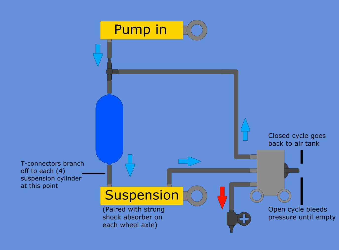

Flecktyphus Posted February 8, 2020 Posted February 8, 2020 (edited) Stupid question (from someone who's been out of the game for 10 years) - would replacing one shock absorber on each axle with a pneumatic cylinder allow easy switching between maximum ground clearance, and "weak" suspension? Or would you simply be stuck with either max clearance/minimum clearance? As in - Pump for increasing pressure, tank if necessary, then T-splits and hoses going to each pneumatic cylinder. The output connectors then connect again and go to a switch, where air can be either let out, or just flow through the hoses. So to be clear (missed in my drawing) - the hoses split off after the tank, going into one cylinder each, then reconnect after their respective cylinders, to go through the switch. Would it work or is there some obvious mistake here? :-) Notice this is all manual, just for (potentially) being able to adjust ride height and stiffness of the suspension. Edited February 8, 2020 by Flecktyphus Quote
pleegwat Posted February 8, 2020 Posted February 8, 2020 You would just have a single communicating network between the cylinder bottoms, the compressor, and the relief valve. The tops of the suspension cylinders would be left open, since you won't be using the compressor to pull the wheels in. I suspect you'd run into the pressure limits of lego pneumatics rather than have this do anything useful, but I couldn't say for sure. Quote
Flecktyphus Posted February 8, 2020 Posted February 8, 2020 Right - that's more logical than how I thought it worked.. haven't played around with this since I picked my 8455 apart right before my dark age. Thanks for the input. I agree that it's probably pushing the limits, I'll see if I can locate any of the old 8455 parts to test the approx weight I can make it hold before things start to leak. With the weight of the 42110 it's probably not very feasible without illegal mods.. Quote

Flecktyphus Posted February 9, 2020 Posted February 9, 2020 (edited) My idea thus far was to pair one x189c01 with a 731c04 on each axle (so hard 6.5L spring suspension & the 5-7L pneu. cylinder). Right now I've got two 731c04 on all axles (replaced the front medium springs). Basically this is what I imagined (with the cylinders being paired with spring suspensions): (What's with the absolutely laughable 24kb max uploads?? At that point just disable them) If necessary I could place a tank (old blue one I have laying around) inbetween the switch and the central T-branch. Placing it before the switch would lead to too quick impingement if I'm not mistaken (built up pressure rapidly fills the system)? Since I'm aiming for a slow and hopefully gradual increase in height, that wouldn't be desirable. Is there any obvious flaw/mistake that somehow would make it not work? And again, it's only intended for manual adjustment of the ride height/suspension stiffness, so I don't have a need to motorize/automate it with PF. Unless the switch you mention is necessary to hold the pressure needed for such operations? Edited February 9, 2020 by Flecktyphus Quote
pleegwat Posted February 9, 2020 Posted February 9, 2020 Having a tank between the pump and the switch would allow raising the suspension more quickly on demand. As you mention, probably not too useful. Having a tank between the switch and the working cylinders would increase the working volume of the suspension, making it weaker. Hence probably the suggestion to use one (or more) large cylinders instead of an air tank: you can couple these with a manual control and compressing the control cylinders would reduce the working volume, hardening the suspension. The ratio between minimum and maximum volume would also affect the force curve exerted by the working cylinders. The amount of force needed to compress the cylinder changes as the cylinder compresses, and the shape of that curve stays the same with increased pressure but changes if the volume changes. I'm not quite sure how noticeable that would be in practice though - I'm working off high school physics only. Quote
Flecktyphus Posted February 9, 2020 Posted February 9, 2020 Very good point, thank you. I'll look into ways of using a cyl as the reservoir. As you wrote it'd be a good idea to be able to quickly change the volume of the system, allowing quick changes between hard and soft (quicker than what you could do by pumping by hand anyway). Would be easier to figure out these things with a bunch of pneu components in front of me but seeing as they're pretty expensive on BL/BO I'll have to do some guesswork before jumping into it. Let me know if this is much too off topic, I figured since I'd be doing this on my 42110, it's okay to be posting here. Quote
Vectormatic Posted February 9, 2020 Posted February 9, 2020 If you want to make it respond relatively slowly to input, you could also take the switched setup pictured above, and use the small compressor pump with a hand crank, that would save a lot of space over a large pump and airtank setup Quote
