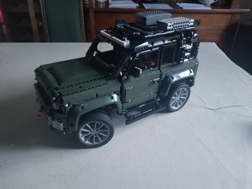

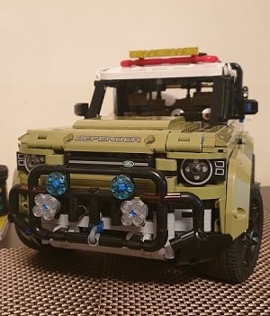

Hey!
Thanks to corona lockdown I got my LandRover set and was very happy to build it up after nearly 17 years lego technic "abstinence". As I really enjoy modding stuff to perfection, I did a few upgrades and would like to share them with you. Main things include: 3rd set of hard red springs for the back axis, dual red hard springs for the front, front and rear bull-bar, trailer winch (will be upgraded soon), side-steps, snorkel, external air-filter, lightbar, some cosmetic addons i.e change of all visible blue pins to black ones and adding some round tiles, exchange of light gray parts to pearl dark grey (ladder steps and exhaust),
For the future I plan to build in a v6 classic engine, ackermann steering, a custom roof top tent, better tyres (maybe not Lego ones) and a suitable trailer thanks to jerry_sutton from rebrickable.
Here is the actual update with 3rd party tires and a new Bullbar variant (Took a day to build it the classic way without studio :)). The tire size is about 90mm diameter and fits very well on the new Lego rims. No issues with steering or rubbing against the fenders. Check on ebay for 1.9 crawler wheels if you are interested.
Edited by harrygee

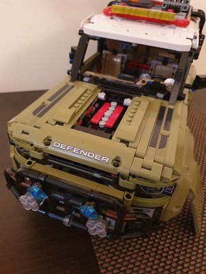

Hi lads,
I fortunately have landed on this topic :) I finished my Defender at the end of January, and it was just the beginning (but my wife is not so happy with this :D). I have made some improvements, more pictures to come, still didn't resolve to lock front doors and I used just the bricks which I found at home, from other sets which are currently dusty, left by children :D (included: handbrake, imitation of clocks, imitation of gas and brake pedals, opened front mask to see how the engine is working without opening it). Good question - how to upload more pictures in one post ...
https://drive.google.com/drive/folders/1w28Sft9yBUyVeiTITErQqhuNv2CIbcho?usp=sharing
