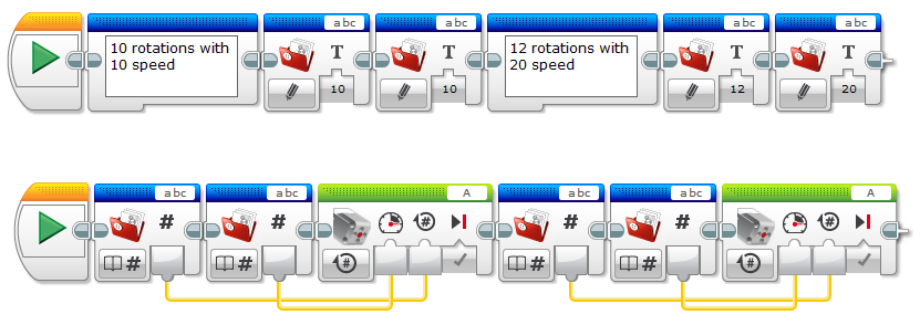

Tcm0 Posted August 11, 2019 Posted August 11, 2019 Which programming language do you use? X3 has the ability to read files. They are in a table format (and I think that they are read as arrays). Quote

Tcm0 Posted August 12, 2019 Posted August 12, 2019 It should work more or less like that. There is no "move X rotations for X seconds" so you would have to calculate the speed from that. I'm not sure about the order the values get read/ written so you might have to write them from last to first. Quote
benredstar Posted August 12, 2019 Author Posted August 12, 2019 8 hours ago, Tcm0 said: It should work more or less like that. There is no "move X rotations for X seconds" so you would have to calculate the speed from that. I'm not sure about the order the values get read/ written so you might have to write them from last to first. Thanks. To clarify - are all those text nodes looking at the SAME external file? How do the motor nodes understand which bit of the text file is relevant to them? /ben Quote
Tcm0 Posted August 12, 2019 Posted August 12, 2019 1 hour ago, benredstar said: Thanks. To clarify - are all those text nodes looking at the SAME external file? How do the motor nodes understand which bit of the text file is relevant to them? /ben The file name is "abc" in this case, it's defined in the upper right corner. The first row is to write the stuff to the file. It's a list that contains "10", "10", "12", "20". The second row is the actual reading process. It reads the first value of the list (I'm not sure if it starts from the beginning with the 10 or from the end with the 20), the second read command reads the second value etc. Quote
vl_cn Posted August 13, 2019 Posted August 13, 2019 A text file in EV3-G looks like; 10 10 12 20 When you use the file read block, it takes a value from the top row and moves on to the next. When you want to return to the top, you have to close it. Also, I believe you can just import the text file to the project. Quote
