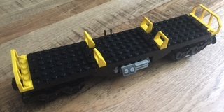

Memo5378 Posted July 27, 2019 Posted July 27, 2019 Hello all, I realise that this may have been dicussed before, but I did not find anything. I need help going around the lack of black 6x28 chassis for freight cars. I would like to use the same wheelsets with the bogie plate. Is there a way to build it with regular or technic plates? Any ideas/mocs to show? Thank you! Quote

Memo5378 Posted July 29, 2019 Author Posted July 29, 2019 So I tried the standard plates and 2x2 turntables option. I am quite satisfied with the outcome. However, it does turn a 15 USD$ car into a 20$ one (give or take), if built with new parts straight from TLG. The standard train chassis is sold 2.29$, and the plates I used total 7.96$ (6x14 are 2.24 each, I used three, 6x6 are .62, I used 2). So it’s a lot more expensive to build in black, but then again cheaper than buying the chassis on Bricklink, the cheapest I saw being sold 42$!!!! I usually don’t buy from BL as I find that people’s price for used parts plus shipping is generally more expensive than buying new.... Anyways, thanks to all who answered. Quote
sed6 Posted July 31, 2019 Posted July 31, 2019 On 7/29/2019 at 1:46 PM, Memo5378 said: So I tried the standard plates and 2x2 turntables option. I am quite satisfied with the outcome. However, it does turn a 15 USD$ car into a 20$ one (give or take), if built with new parts straight from TLG. The standard train chassis is sold 2.29$, and the plates I used total 7.96$ (6x14 are 2.24 each, I used three, 6x6 are .62, I used 2). So it’s a lot more expensive to build in black, but then again cheaper than buying the chassis on Bricklink, the cheapest I saw being sold 42$!!!! I usually don’t buy from BL as I find that people’s price for used parts plus shipping is generally more expensive than buying new.... Anyways, thanks to all who answered. You've fallen into the same trap that I did (and probably everyone else) when first building a chassis. You don't have to limit yourself to such large, expensive plates. You could achieve the same thing by using 7 of the 4x6 black plates which are only $.10 each. Multiply that by two layers and you're at $1.40 for the whole chassis. As your chassis designs becomes more complicated you will find large plates become less suitable anyway, or at least I did. You might also consider downloading Lego Digital Designer, LDD, and using that software to examine different train cars that other people have built, to get an idea of some additional building techniques. You can find examples of other peoples work on sites like this or on Bricklink (in the MOC section) or on Bricksafe. Here's a link to my Bricksafe folder, where I share all of my rolling stock and locomotive designs, complete with the LDD file, for other people to examine, modify or copy my designs. https://bricksafe.com/pages/sed6 Quote
