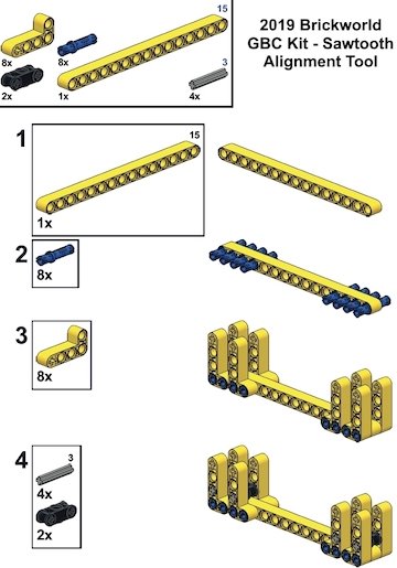

I built the sawtooth module. An in the instruction it mentions an alignment tool but no where can I find out what that is or even where to get or build it - any thoughts or suggestions
So, build this tool, put the center section of the saw tooth in the UP position, this tool will slide in from the bottom, hold it in place as you attach the motor and gears sub assembly....
Edited by Sam_F
