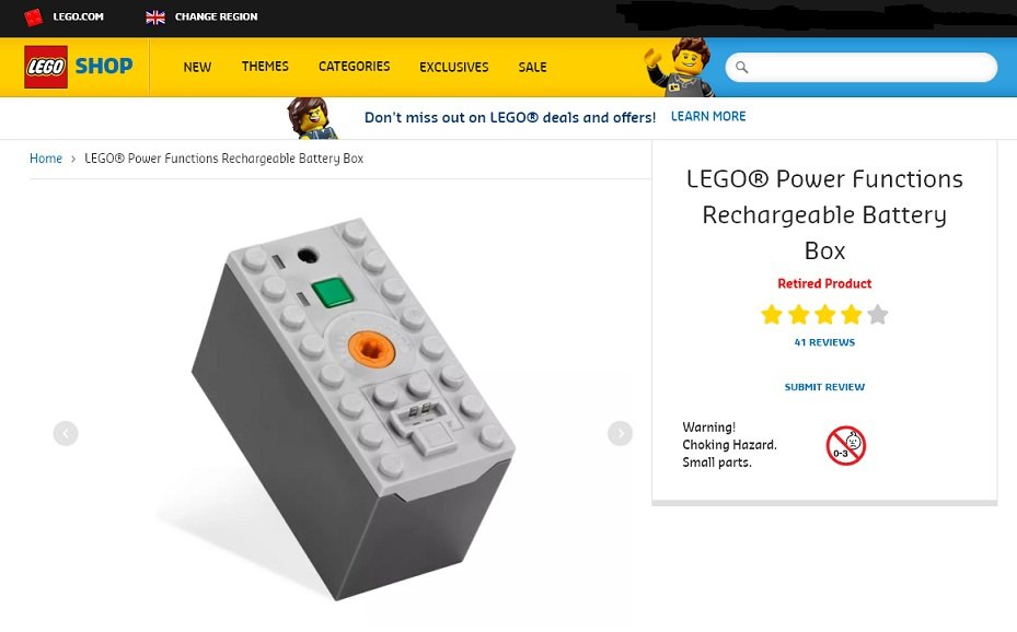

Looks like LEGO have retired the LEGO® Power Functions Rechargeable Battery Box 8878 according to the product pages. Does anyone know if they are replacing this with anything new or whether we just have to use the AAA standard battery box going forward?
Edited by mojot83
Well I don't.
All I know for sure though that this is one of finest pieces of equipment TLG has ever released. As simple as that. The dial, the charging behavior. Perfect.
I have no clue why they discontinue that box - maybe someone has swallowed it. Or found a way to blow out the LiPo. I have no clue. I have several of them and they rock.
