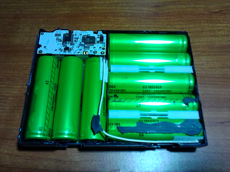

Thai bricks Posted May 28, 2020 Posted May 28, 2020 I can't stop thinking: if somebody needs more capacity you can relatively easily put 2 sets of 2 or 3 LiIon into the battery box, i.e. 2P2S or 3P2S. But you really have to get your wiring right! Quote
