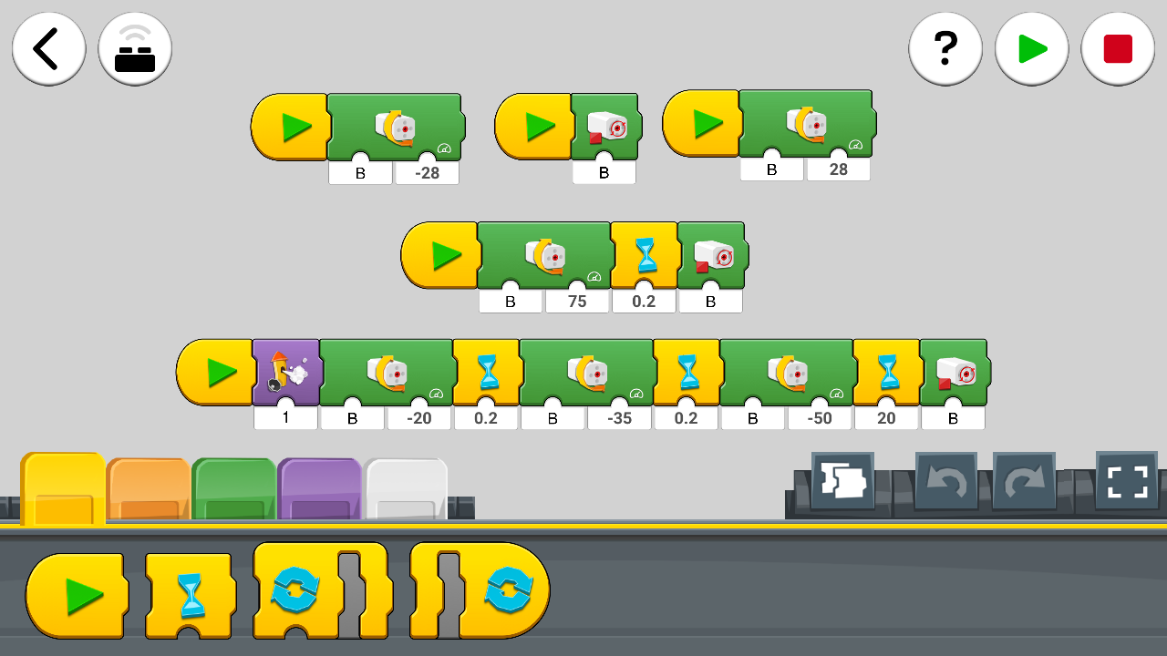

Paperinik77pk Posted August 6, 2019 Posted August 6, 2019 On 7/31/2019 at 1:24 PM, Roadmonkeytj said: Possibly but what and how would I mount it so it doesn't get ripped off. So far I only have two coupler issues ... One super weak and one super strong. I noticed if I control the train with the PUP app that 10% is realistic speeds but you need the 30% instant "snap" that the controller gives you .... Anybody know how to change the controller output yet? At 10% on the slider the train moves perfect but dragging to 30% is just too slow and causes the train to spin its wheels. But one click of the controller is the ticket. Sometimes you have to pushe the cars back then reverse to snap. Hi @Roadmonkeytj, you are creating something really special , I'm following this thread from its beginning, looking at all your great solutions!!! The App has the possibility to create some "programs" that can be executed without using the standard sliders. I tried a bit the application in order to solve a problem with my big G scale toy train (the Medium motor does not allow adjustable speed with the standard controller, and I do not like the way sliders work on the APP). I therefore created some small programs to achieve different speeds, to stop, to turn on lights and so on). So for example , you can create a program for each activity you need: One to allow slow coupling (START>SPEED SET 10%>TIME LIMIT 3), another one to allow fast decoupling (START>SPEED SET 30%>TIME LIMIT 3), one for moving forward at a fixed speed (START>HORN>SPEED 40%) or backwards (same as forward with speed -40%), one for stopping the engine (START>SPEED 0%>BRAKE SOUND). Problem is...you also need to create a tablet/smartphone holder Quote

Paperinik77pk Posted August 6, 2019 Posted August 6, 2019 (edited) 4 hours ago, Roadmonkeytj said: I will have to give that a try ... The only thing is the train consists will be randomly chosen so the Time the train travels might be different each time Thank you for following though. Ive been excited as I build to see how the public responds. My fault, I explained it badly - plus I wrote a wrong workflow (I forgot a command). The "duration" is valid only for approach/coupling and decoupling. Setting a small amount of time will make the locomotive to move at desired speed only for a second, or two. - START>SPEED SET -10%>TIME LIMIT x>STOP - this will allow the locomotive to make a slow movement backwards and stop quite immediately. - START>SPEED SET 30%>TIME LIMIT x>STOP - this will allow the locomotive to make a fast movement forward and stop quite immediately. This should give enough power to un-couple. When the locomotive has to travel on free track, you can use the fixed speed controls START>HORN>SPEED 40% or START>HORN>SPEED -40% - but obviously you'll have to stop the locomotive manually. The programming is nice since you can emulate gradual acceleration and stopping, which adds realism. Edited August 6, 2019 by Paperinik77pk Quote

Roadmonkeytj Posted August 8, 2019 Author Posted August 8, 2019 On 8/7/2019 at 4:22 AM, Paperinik77pk said: it's a bit of trial and error approach That it was I was able to program a forward reverse and stop in slow then a decouple that was a blast of power then off. Then just for fun I made a victory lap sequence. Main issue I had with the slider is the chains you build move around on the board as I try to press them ... Do you know a way to lock them in place once built? I did take a video ... Is not the best quality as its the laptop camera but it does show all 11ish minutes of me solving a random train. So had to speed the video up to 4x Here is the custom Api Quote
Paperinik77pk Posted August 12, 2019 Posted August 12, 2019 On 8/8/2019 at 3:53 PM, Roadmonkeytj said: That it was I was able to program a forward reverse and stop in slow then a decouple that was a blast of power then off. Then just for fun I made a victory lap sequence. Main issue I had with the slider is the chains you build move around on the board as I try to press them ... Do you know a way to lock them in place once built? I did take a video ... Is not the best quality as its the laptop camera but it does show all 11ish minutes of me solving a random train. So had to speed the video up to 4x Great work!!! The problem with "moving" chains is the same I'm experiencing in my video...I tried to lock them in place, but no way! Quote
