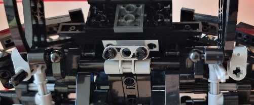

KKO Posted April 11, 2022 Posted April 11, 2022 (edited) On 10/13/2020 at 11:21 AM, Seely said: Thanks, yes, Peter Schrott has already told me. Here‘s my Result Hi, could you share how you made the rear wing? I built it based on photos, and it is half a stud wider on each side, so it doesn't connect right to the "linear actuator" EDIT: took a while, but I've managed to fix it Edited May 12, 2022 by KKO Quote

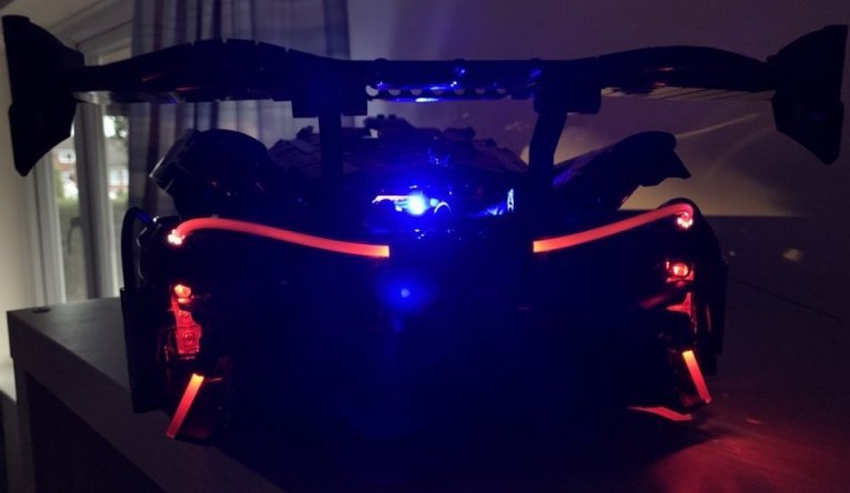

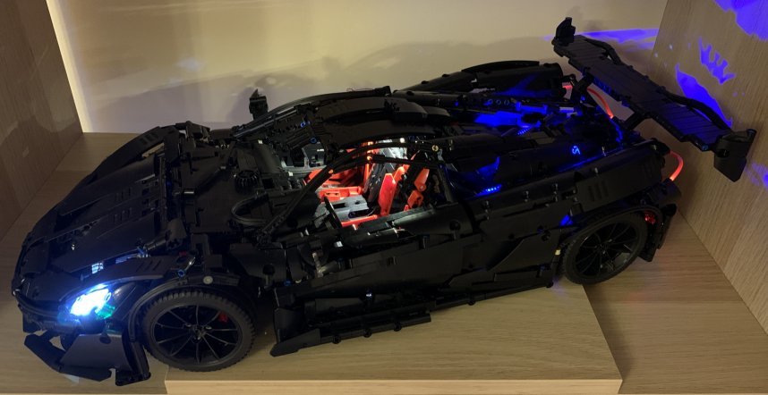

Flobadobbob Posted August 13, 2023 Posted August 13, 2023 Finally got my lights sorted after much internet searching. Looked at the light options listed in the pages prior for the rear light. Light My Bricks wanted £35 just for the one rear light for the Bugatti!!! In the end I took a gamble and purchased the base Lighting kit for the Bugatti from game of bricks. LEGO Bugatti Chiron 42083 Light Kit (gameofbricks.eu). With the GOB10 code knocked the whole lighting set to £16 delivered. 1 week later it arrived but it appeared the rear light strip was actually a strip of red leds behind the red tube. Doh! But I soldiered on and used the 8 single front light sets for the rear and am very pleased with the result :-) Rears used all but 2 of the Bugatti front white lights and existing red tubes, LEDs fit straight in the red tube supports. 2 sets of the Bugatti rear light strips trimmed for the brake lights held on with tape Engine bay I used the adhesive backed blue light set Interior the adhesive backed white set Front used the last 2 remaining Bugatti front white lights sat in the technic light pieces without adhesive. To make the front look better I've ordered 2 more front LEDs but some how blagged these for free through misunderstanding emails and language barrier :-) Pic of whole car with light sets Quote
