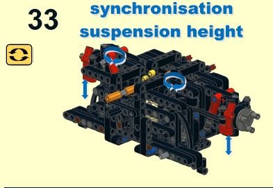

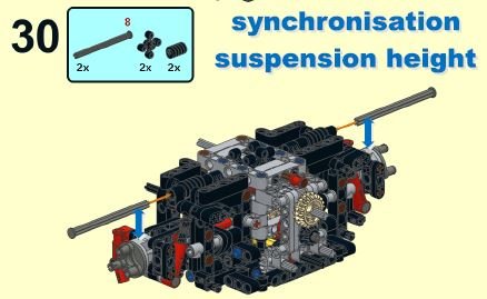

lego_tactics Posted September 6, 2019 Posted September 6, 2019 @brunojj1 as I prep to start this build and reviewing the instructions a few times, can you go into more detail of how you synchronize the suspension (mainly what it should look like when properly done) and what you mean about setting up the air brake. Thank you in advance and can't wait to get this build complete as it is one of my favorite cars out there. Quote
brunojj1 Posted September 6, 2019 Author Posted September 6, 2019 (edited) @lego_tactics The synchronisation is easy theoretically, but take your time to level it right. The front axle is a bit tricky because it has some play (the chassis is not rigid in some areas at this stage). Start at one end, wind it up or down to the max at one side and then the other. Then add the knob wheels left and right of the yellow one, while trying not to compromise the heights on one of the sides by turning them. Then wind everything up by turning the orange centre axle - let´s say up to the middle position. If both sides are horizontal, everything is ok. If not, play around until you´re satisfied. Same for the rear axle - it´s easier to do it here, you have simply to pull out the 8L axle w/ stop and reinstall the knob gear to get it equal. On the first picture you have shown the final adjustment between front and rear axle which can be adjusted individually, disconnecting them by pulling out the 5L axle by 1 stud. The air brake is admittedly hard to put together. But once assembled, you just have to find the middle position by moving the grey 16t gear on the bottom of the car which I called the airbrake activator and find the neutral position from where it will have the same travel while turning the steering wheel left or right. Don´t worry, I´m sure you´ll get the idea and find out everything during the assembly . Edited September 6, 2019 by brunojj1 Quote
lego_tactics Posted September 6, 2019 Posted September 6, 2019 @brunojj1 thanks for the step by step on getting these steps just right. Like you said once there during the build I’m sure things will start to make sense. Thank you Quote

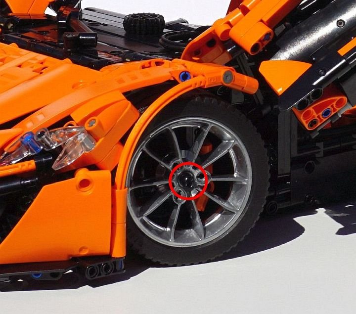

gethema Posted October 22, 2019 Posted October 22, 2019 hi guys, I was wondering whether these wheel caps are custom made parts? I couldn't find them listed in the inventory, and I'm looking for some nice fitting caps for my Mclaren. Thanks! Â Quote
imvanya Posted October 22, 2019 Posted October 22, 2019 (edited) 1 hour ago, gethema said: hi guys, I was wondering whether these wheel caps are custom made parts? I couldn't find them listed in the inventory, and I'm looking for some nice fitting caps for my Mclaren. Thanks! Looks like this part to me. The recent Porsche 911 RSR set had similar caps as well, actually. Edited October 22, 2019 by imvanya Quote
gethema Posted October 22, 2019 Posted October 22, 2019 1 hour ago, imvanya said: Looks like this part to me. The recent Porsche 911 RSR set had similar caps as well, actually. Perfect, thank you very much for your quick help! :) Quote
brunojj1 Posted October 22, 2019 Author Posted October 22, 2019 7 hours ago, gethema said: hi guys, I was wondering whether these wheel caps are custom made parts? I couldn't find them listed in the inventory, and I'm looking for some nice fitting caps for my Mclaren It´s simply the lower part of the mini antenna , you might have them lying around for decades.. Quote
gethema Posted October 23, 2019 Posted October 23, 2019 On 10/22/2019 at 4:44 PM, brunojj1 said: It´s simply the lower part of the mini antenna , you might have them lying around for decades.. Haha! Brilliant, yet simple and clever solution! Would have never thought of that Thank you! Quote
