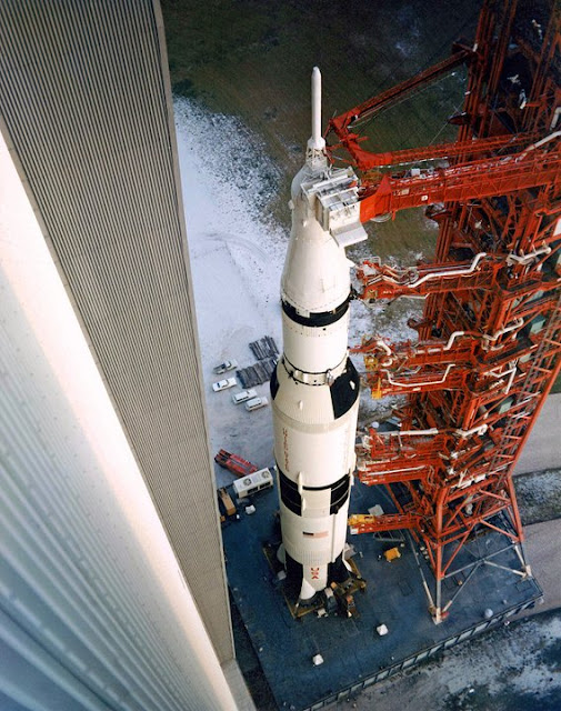

A bit of an old comment, but I'm revisiting it because it's part of the ongoing headache I'm having with the crew access arm.
After the previous go around I've got all of my decks within a plate or so of the correct 110:1 height; and the bottom 6 arms are all where they're supposed to be relative to the rocket.  Based on that I'm assuming the S-IC and S-II stages are both about the right height.
Arm 7 is at the right height on the LUT but about 1 brick high relative to the black ring at the top of the S-IVb.  I'm not critically concerned there, although I might lower it a plate or so.  Trying to tweak the height of the rocket stage is more complex than I care to think about doing anyway.
The bigger problem is arms 8 and 9.  The full impact of the 2 brick too tall launch escape system is weighing in here.  Arm 8 should centered halfway between the two decks to reach the service module, and the bottom of arm 9 should be slightly below line with it's deck.  But what I actually have is arm 8 aligned with the bottom of its deck, and arm 9 aligned with its top in at deck height.
I'd been semi-aware of this for a while, but until I started trying to build the scaffolding to access the arms it hadn't really mattered.  At this point I don't see a good way to make it work without adding 2 bricks to the upper part of the rocket and redoing the launch escape system to be shorter.  As I commented earlier, adding an extra brick of height to the S-IVb stage is way more work   That leaves the payload fairing, service module and command module as places to add additional height.  The easiest spot to do so would be the bottom of the fairing by adding 2 more rows of macaroni bricks (and with the black ring at the top of the S-IVb a brick low, probably at least half the height adjustment should be done here).  I'm going to hold off doing that until I can hunt down heights for the manned parts of the rocket because if I can justify it, I'd rather add it to the manned section instead.
My current LUT (complete with backing around the arm pivot).
Apollo 13
