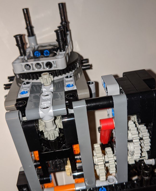

Re Rotary Dumper:
Runs very smoothly. Very good MOD using Z56 turntable instead of double gear racks.
I see you are using the older type 8T gears, if you have them the new stronger 8T gears are better.
Can you post a close iup mage up of the Z56 t/t end showing the support structure.

Below is a picture of where the rotating chassis connects to the main structure. It plugs right into the support tower in the original Akiyuki design.
