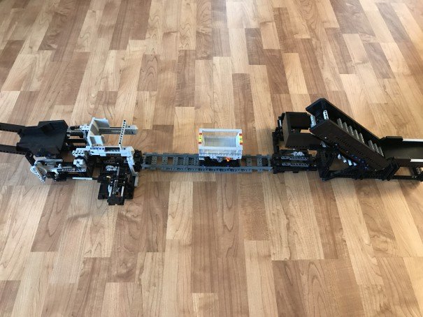

Nudipics Posted March 14, 2019 Posted March 14, 2019 I joined this forum because I need help from the experts. I recently built the basic Akiyuki train set up with loader and unloader using Akiyuki's instructions from his website. I can not get it to work right however. Although the train unit seems to have plenty of power it does not successfully operate the reverse units. The motor seems to not have enough power and in some cases binds up. I have installed new batteries and even switched out M-motors but the results are the same. I've used the soft spring shock absorbers on the reverse units so there shouldn't be a problem there. I'm at a loss for what could be wrong. All the videos I've seen of this model work flawlessly. Please help. On 3/14/2019 at 11:13 PM, rskamen said: I am having a problem getting the correct part number for the 4 train wheels needed for the train unit. Cannot seem to find it on Bricklink. The number in the parts list does not seem to exist. Can someone point me in the right direction? I have a parts order ready to go and want to see if I can add the wheels to it. Expand The part number for the train wheels is 55423c01 On 3/14/2019 at 11:13 PM, rskamen said: I am having a problem getting the correct part number for the 4 train wheels needed for the train unit. Cannot seem to find it on Bricklink. The number in the parts list does not seem to exist. Can someone point me in the right direction? I have a parts order ready to go and want to see if I can add the wheels to it. Expand @rskamen The part number for the train wheels is 55423c01 Quote
rskamen Posted March 15, 2019 Posted March 15, 2019 @Nudipics Thanks for that quick reply. I was able to find the wheels and include them in my Bricklink order. As far as your reverser problem, look at some of the earlier postings by @Berthil and how he modified the "pole Reverser Switch".. If you are using a new style switch, the indents are too tight. The switch needs to be opened up and the indents cut away. I ordered new style switches and plan to grind down the indents with my Dremel tool so the move smoothly and not "click" into position. Definitely check some of the early pages on this forum. Quote
Nudipics Posted March 15, 2019 Posted March 15, 2019 On 3/15/2019 at 12:22 AM, rskamen said: @Nudipics Thanks for that quick reply. I was able to find the wheels and include them in my Bricklink order. As far as your reverser problem, look at some of the earlier postings by @Berthil and how he modified the "pole Reverser Switch".. If you are using a new style switch, the indents are too tight. The switch needs to be opened up and the indents cut away. I ordered new style switches and plan to grind down the indents with my Dremel tool so the move smoothly and not "click" into position. Definitely check some of the early pages on this forum. Expand @rskamen I've already modified the switch (I just took a nail file to the friction notches, smooth as can be). My problem is that the train unit doesn't power through the reverse units at the loader and unloader unit. I searched through a lot of this forum to see if anyone mentioned the same problem but no luck. I'm hoping someone has had a similar problem and can offer a fix. Fingers crossed. Quote
doug72 Posted March 15, 2019 Author Posted March 15, 2019 (edited) On 3/15/2019 at 1:13 AM, Nudipics said: @rskamen I've already modified the switch (I just took a nail file to the friction notches, smooth as can be). My problem is that the train unit doesn't power through the reverse units at the loader and unloader unit. I searched through a lot of this forum to see if anyone mentioned the same problem but no luck. I'm hoping someone has had a similar problem and can offer a fix. Fingers crossed. Expand Have you done the mod to the axle between the two wheel axles ? The Akiyuki version can suffer from high friction on the axle between the two train wheels axles. Replace the 4L & 5L axles with stops & the 2L connector with a plain 9L axle. Can you post an image of the underside of the train unit ? Ensure you that the train wheels with discs are not rubbing on the frame. With train removed from reverser , rotate the 24T gear, that the 8T gear engages with by hand to check if any friction. Edited March 15, 2019 by Doug72 Quote
Berthil Posted March 15, 2019 Posted March 15, 2019 (edited) @Nudipics welcome to the Akiyuki train group. I don't think we had this problem before. My only advice is to operate the switches by hand, so turn the 24t gear by hand that is normally driven by the train and feel if the resistance is too big. If so check if anything is overtightened or has bend axles. Even do the same in the train without the motor. How is the speed of the train? Like you see in the video's or slower? I see Doug also responded. If you want to see the 9L axle you can have a look at my Rechargeable train instruction which has the 9L axle. Edited March 15, 2019 by Berthil Quote

Nudipics Posted March 16, 2019 Posted March 16, 2019 (edited) On 3/15/2019 at 8:13 AM, Doug72 said: Have you done the mod to the axle between the two wheel axles ? The Akiyuki version can suffer from high friction on the axle between the two train wheels axles. Replace the 4L & 5L axles with stops & the 2L connector with a plain 9L axle. Can you post an image of the underside of the train unit ? Ensure you that the train wheels with discs are not rubbing on the frame. With train removed from reverser , rotate the 24T gear, that the 8T gear engages with by hand to check if any friction. Expand @Doug72 @Berthil Thank you gentlemen. I decided to start by rebuilding the train unit. I switched out the axles replacing with the 9L and paid attention to the tension between the train wheels, hubs and gears. It's working flawlessly. Thank you for your suggestions and hopefully this will help folks in the future. Edited March 16, 2019 by Nudipics Quote
doug72 Posted March 16, 2019 Author Posted March 16, 2019 (edited) Good to hear you have fixed the problem & train now running OK. You missed my earlier posts on Page 8 for August 20th & 22nd about this problem & the solution. Doug72. Edited March 16, 2019 by Doug72 Quote
