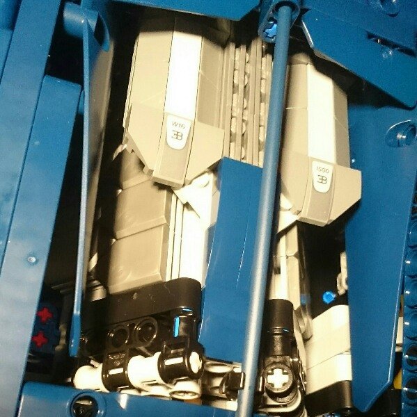

The w16 engine

First of it i want to motion about is 99% of the MOC build is using LEGO, just only a few parts and pf(s) are not made by lego.
And they are:
The 4 white&black wheel arches which TLG does not have this colours.
The 4 Red wheel which TLG does not have this colours.
The PFs, I am living in Hong Kong, buying official PFs is expensive like hell here specially i have 8 XL and lots of other things in this build.
And this is it. All Lego.
8x XL 12:20 (0.6) drivetrain - works fine, but i only test a few mins, no slack. last time i have write the radio wrong. XD
1x Servo for turning - works well
2x M for the Door / Pneumatic Dynamic Suspension control - Not working, problem solving in the latest LDD save but....
1x M for the w16 engine - works well
1x L for the Pneumatic air power - works well
1x Servo for the "Pneumatic Driven Clutch Brakes & Pneumatic Rear Spoiler Control & Door / Pneumatic Dynamic Suspension control" switch - works well, but have problem with Pneumatic Driven Clutch Brakes.
Problem with Pneumatic Driven Clutch Brakes, it does not activity as expert, once the clutch is in engaged in, they will not engage out and start slacking. Even it is not on engaging ! wtf !
Still trying to fix it, the worst of this is give up the Pneumatic Driven Clutch Brake, just straight out the drivetrain to the wheel.
Pneumatic Rear Spoiler Control & Door / Pneumatic Dynamic Suspension control - works well
Pneumatic Dynamic Suspension - Built, not yet tested
