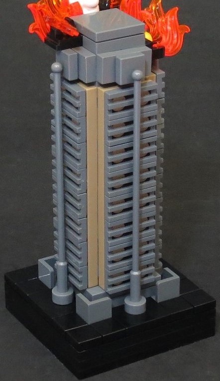

Im looking to build the below nakatomi plaza from die hard as seen in the picture.
I can see how the exterior tile pieces fit together but can anyone direct me to how i build the interior of the tower?
As all 4 sides have the same out facing bricks i cant figure out how it all fits together.
Direction to what bricks i would need to achieve the picture would be really helpful also.
Thanks in advance for any help anyone can provide.

I can think of a few ways that the tower might be put together, this is one of the simplest:
Five plates = 2 studs, so you can use the 1x1 bricks with a stud on the side to build outwards.  Two plates between each brick keep the sideways studs lined up properly. You can use either the 1x1 with a single stud on the side, or there are new bricks which have 2 studs on adjacent corners.
Of course, you don't have to start the central core with two plates on the bottom, you can start with the 1x1 bricks... this can give a nice vertical offset.
