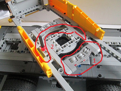

Custom turntable modified by removing the two side three wheel supports.
Centre turntable changed from Z56 to Z60 with has less friction, as it now only acts for centring the custom turntable.
The remaining  wheel supports more than adequate for fore & aft forces.
Slewing is by a an 8T gear messing with 13L gear ring internal teeth.
M motor with 8:1 reduction (worm / 8T gear) to give overall reduction of 100:1 for good slewing speed, not too fast & not too slow.

Hi Doug!
Your creature is very promising. Thank you for sharing.
On your picture I found two unknown for me pieces. In which set you've get them? Roll bearing holder (1) and curved gear rack (2)?
1 hour ago, Ox1337 said:
Hi Doug!
They are not Lego parts, they are 3D printed and were designed by Efferman and are available from Shapeways.
https://www.shapeways.com/marketplace?type=product&q=efferman
13L studs size in white.
https://www.shapeways.com/product/KGVVXXQ8Z/wheelholder-for-turntable-support?optionId=58698690&li=marketplace
https://www.shapeways.com/product/CBJHXEZWV/turntable-support-13-studs-diameter?optionId=58697999&li=marketplace
Also availabe in a larger siz of 17 studs.

I brought two sets when Efferman first designed them and have used them in previous MOCs, i.e Level Luffinfg Dock Crane.
That are very useful for MOCs that should use a larger turntable for stable slewing and reduce turning friction.
They are ideal for my current MOC where a Z56 or Z60 turntable would not support the rotating structure very well - the turntable is only used to centre the 3D components.
They are now available in 3 sizes: 11L / 13L / 17L, you can use two sets wheel supports or for heavy loads 4 sets.
The wheels are Lego p/n 42610 LEGO Wheel Hub Ø11.2 x 8 with Centre Groove  and held in place using 2L red axles.
3D parts are in white and I used a grey paint pen to colour them which is a close match with Lego light grey.
Edited by Doug72
