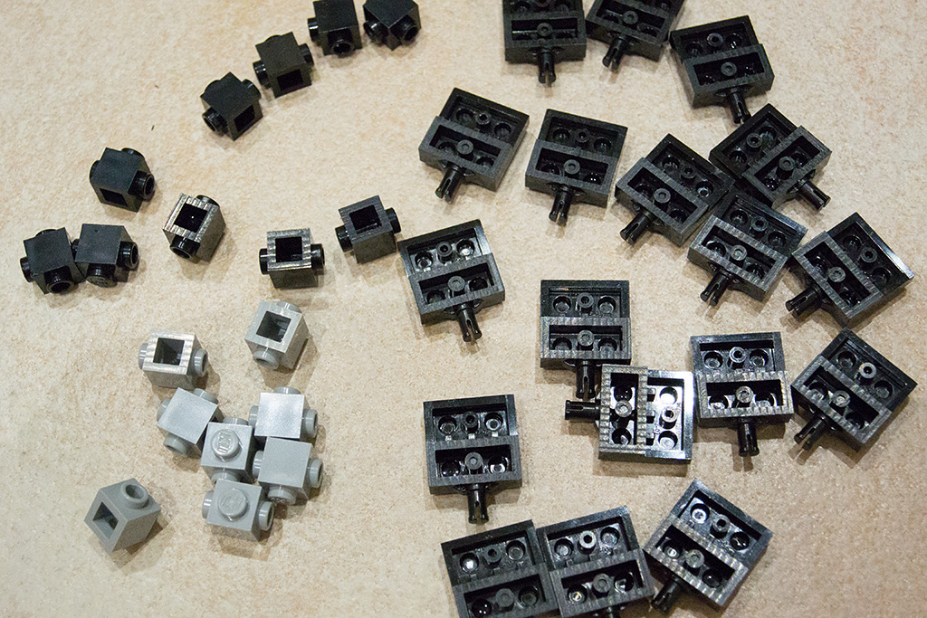

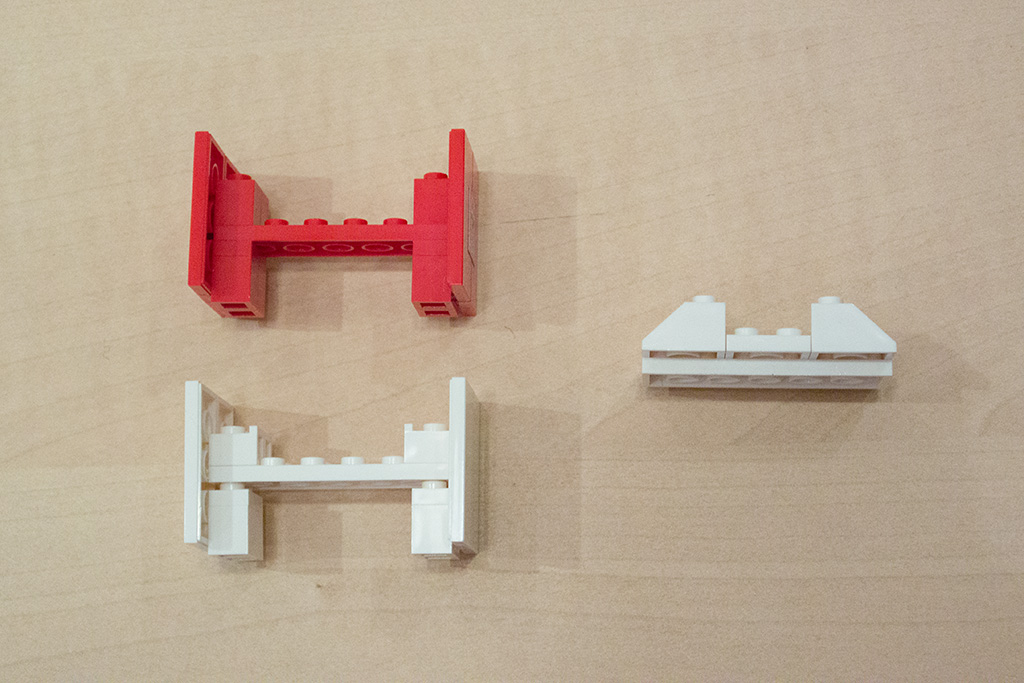

First, I removed 1.6 mm (half of a plate height) from the bottom of the bearing elements and the 1x1 bricks using a CNC mill (Stepcraft 600). You can see a the milling here: https://www.youtube.com/watch?v=rCAWKObQn_U.
Below are the modified parts:

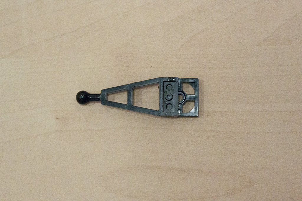

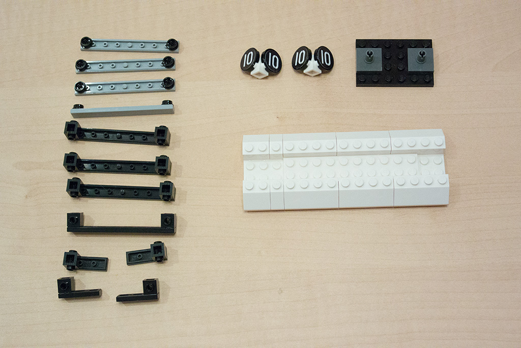

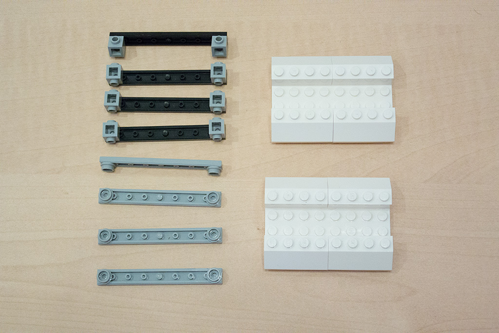

To make the model robust enough for playing I glued together all parts shown below:
The drawbar between the tramway and its trailer is to high to pass switches, too. Fortunately, this can be fixed be removing the bottom plate. To remain stability, I used glue again:
I've used a special glue for ABS plastic:
To make the tramway run smooth, I used the machine grease shown below. According to the instructions it is suitable for plastic. The results are really stunning the, a single motor is enough, even for inclines and the noise is pleasant:
Btw, the grease is also highly recommend for the Lego 60097 City Center's tramway, which has the same wheel issues. I've used it on all my models with small train wheels.
