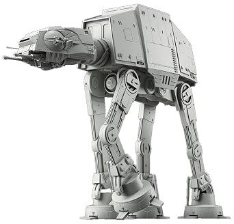

But have you measured the leg's thickness of the "original" model to match 1 brick thickness at minifig scale?
Well first "minifig scale" is subjective & has a pretty wide range, going from a scale to its double, thus pretty much a brick to 2 bricks.
Second, Cavegod's model is enormous, as well as this other (IMHO even better) one (edit: I see dmaclego already replied above). I know the AT-AT's legs are thin, but so are these, they don't appear abnormally thick to me. Well, compare them to Bandai's model kit (you won't find better than Bandai's kits as for accuracy). 1-brick thickness would be way too thin.
