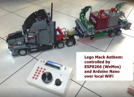

RaveEib Posted July 15, 2021 Posted July 15, 2021 (edited) As a hobby programmer of microchips such as Arduino controllers, I used them to make my model truck moving. The truck is moved by a PF XL motor, the steering is done by a servo, both controlled by a WeMos microcontroller. The chip communicates over local WiFi with the self-made control panel. An Arduino Nano supported by a L298D H-bridge is responsible for the trailer functions: - outrigger moving, done by two Mini motors - suspension moving, done by two servos - switching the magnets to lift the Playmobil boxes The Nano gets its commands via a serial link to the Wemos. A push on a button starts e.g. up- or downloding of the box. Here is a video: https://youtu.be/GgyzbxhsYYI Edited July 15, 2021 by RaveEib Quote
