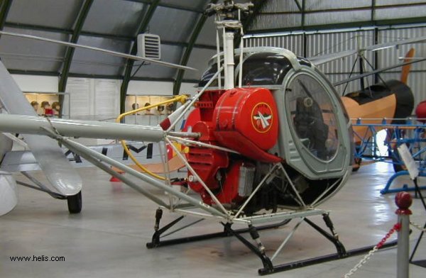

MangaNOID Posted November 26, 2017 Author Posted November 26, 2017 (edited) Who would have thought that these helicopters had a piston engine! just another function to squeeze in as soon as I realised that. a flat four with belt drive up to the main and rear rotors. attempt one was ok but the 5x7 frame started getting in the way when trying to nut out the swash plate controls. so I built a 'c' frame that is surprisingly rigid and leaves plenty of room for the controls bottom part of swash plate on I surprisingly quite close to keeping all in the right place/scale to each other. the only thing so far is the engine and belt drive are tilted front down on the real one slightly and there is no way I have the abilities room to do that. colours are not final and I hope to put more detail in like the real one but nutting out the mechanics still of course. EDIT: does anyone know if there is LEGO rubber band that may fit between the two cranks to replace the chain? Edited November 26, 2017 by MangaNOID Quote
