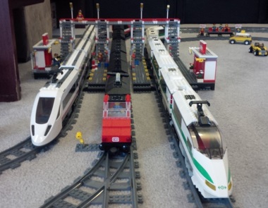

Breakdown Posted September 27, 2017 Posted September 27, 2017 My 7745 is 7 cars long and runs with power functions. You can buy the LED lights for $7.99 CAD online at the Lego store, I did some mods to the 7745 and the LED lights poke through (once you remove the prisms on the 7745 easily). It's hard to feed the wire for the Pf through the base for the 7745, I had to tap might a couple of times with a weight brick to force it through. The other thing that I did with the 7745 train is alter the roof from 33 degree slopes to 45 degree ones. The painful thing will be acquiring the ones to form the front end. I've left all of the other cars @ 33 degree roofs. You can barely notice and that's if you're really looking. If you have 2 X 60051 you will only be able to complete one middle car extra before buying extra pieces. The 7745 actually goes with the 60051 pretty well. Unfortunately the pic below is the back of my 7745 which still has the 33 slope roof, and no power functions. Quote
