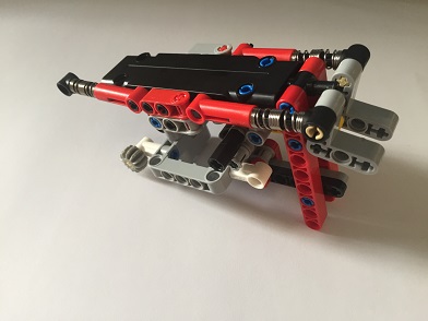

Anyway, using some of the design principles in the 8880 set, i developed the prototype design. A key goal of the design has been to try and reuse some of the left over parts of the original set but where functionality is being compromised, new parts had to be introduced. The development is split into 4 parts:
1. Front to Rear Steering Transfer Mechanism
This mechanism is designed to fit Didumos69's modified steering module as incorporated by Kumbbl. See picture below for a view of the Transfer Mechanism which also shows part of the Rear Steering Path.

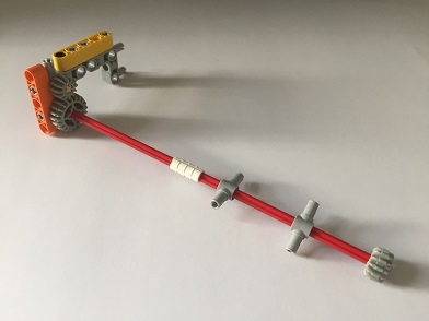

2. Rear Steering Drive Path
I've managed to hide the drive path behind the central segment of the car which is covered by black curved panels. This keeps the solution neat and hidden away, The remainder of the mechanism is shown below including the rear axle steering rack.

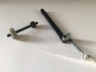

Rear Axle Re-design
The largest challenge turned out to be the rear axle re-design. The forward suspension strut has to be re-located as it interferes with the steering link and so i decided to move both the forward and rear struts to the top. This is probably the most controversial change, but i expect it will look very good on the car as it will be visible through the rear windscreen, when the body is mounted.
