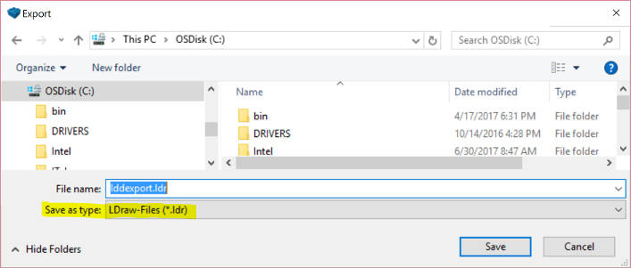

IstakaCiti Posted July 13, 2017 Posted July 13, 2017 You can convert to ldraw with these steps: In LDD go to file -> export In the export box set save as type to Ldraw-file. See the screenshot. However, based on my personal experience if you have already done a model in LDD using blueprint is easier. Because for LPub3d as well you need to first arrange the parts in different steps manually. Unfortunately there is no easy way to create instructions unless you build the model that way in any of the ldraw tools (e.g. LDCad, MLcad or stud.io. Quote
