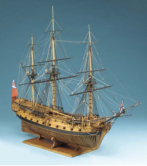

After a lifelong interest in fighting ships and Lego, I would like to attempt a minifig scale version of a Royal Navy Roebuck class fifth-rate. Perhaps the HMS Diomede, or even the HMS Serapis. Being the first true ship MOC i've done in over ten years, I would appreciate some input on how to proceed. It seems that most minifig scale mocs are somewhere in the 1.35 to 1.44 range, and I'm curious as to how experienced Historical Ship MOCs have leaned on that curve, and how it translates to stud measurements. Being an attempt on minifig scale, it'll be a brick-built hull; but i doubt ill try to have a full minifig complement crew as i would like to go the custom minifig route. With a 1.4 conversion, that would make a 100 by 27 stud design from gundeck and beam measurements.
Roebuck class dimensions are:
Type:Fifth-rate ship
Tons burthen:879 26⁄94 (bm), (as designed)
Length:
140 ft (43 m) (gundeck)
116 ft 4.375 in (35 m) (keel)
Beam:37 ft 9.5 in (12 m)
Depth of hold:16 ft 4 in (5 m)
Sail plan:Full-rigged ship
Complement:280 (300 from 1783)
Armament:
Lower deck: 20 x 18-pounder guns
Upper deck: 22 × 9-pounder guns
(later upgraded to 12-pounder guns)
Quarterdeck: nil
Forecastle: 2 × 6-pounder guns
Any feedback is greatly appreciated, as well as tips and other thoughts.
