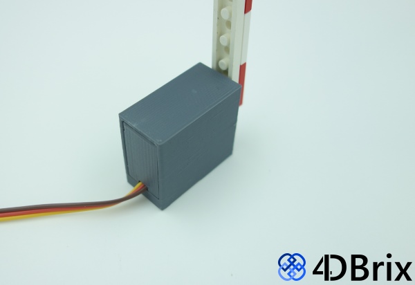

Lowa Posted January 12, 2017 Posted January 12, 2017 To all LEGO train automation enthusiasts, Now that our track switch motors are out, I finally found the time to make a short clip of the first fully functional prototype of our level crossing motor. The main goal was to have a small motor specially designed level crossing barriers. We managed to pack a tiny digital servo into a brick that measures 2 studs wide, 4 studs deep and 3 brick high (16x32x28.8mm). In front, the motor has a 'square stud' to attach the barrier. In this setup I also added a prototype of our 'train traffic light' that I put on its side and added 2 red transparent 1x1 round LEGO bricks. The motor and light are controlled with our nControl software. The final motors would be printed in black, as I assume that would be the most requested color for barrier motors. Let us know what you think. This is not a final product, so all feedback/questions/suggestions are welcome! Quote

Lowa Posted January 13, 2017 Author Posted January 13, 2017 FYI: the wire comes out of the motor at the bottom. Internally the wire comes out of the servo motor at the top, but I managed to find the space inside the brick to run the cable down to the bottom so it's easier to hide the cable in your layout. The picture below shows a prototype without studs, the final motor will have 8 studs on the top surface. In the video, the wire of the light comes out at the side, but that's because this is a 'traffic light' on its side. I'm planning to make a variant with cable coming out at the side of the light; so if you put the light on its side like in the video the cable comes out at the bottom. Quote
CrispyBassist Posted January 13, 2017 Posted January 13, 2017 On 1/13/2017 at 3:00 PM, Lowa said: FYI: the wire comes out of the motor at the bottom. Internally the wire comes out of the servo motor at the top, but I managed to find the space inside the brick to run the cable down to the bottom so it's easier to hide the cable in your layout. Expand How small is the servo itself within the brick? Quote
M_slug357 Posted January 14, 2017 Posted January 14, 2017 @Lowa, Just a few suggestions: -Maybe make a groove on the side of the motor housing that could accommodate the light unit's cable? -What's wrong with dark grey? You should offer both color options (and maybe white for dying/painting?) if possible! Other than that, this looks great! Quote
Lowa Posted January 17, 2017 Author Posted January 17, 2017 On 1/14/2017 at 3:39 AM, M_slug357 said: @Lowa, Just a few suggestions: -Maybe make a groove on the side of the motor housing that could accommodate the light unit's cable? -What's wrong with dark grey? You should offer both color options (and maybe white for dying/painting?) if possible! Other than that, this looks great! Expand There are no technical issues with a making those motors in various colors, it does however complicate the logistics. If you want something in a specific color, you can always ask and we'll do it; we don't charge anything extra for that. But offering the these motors both black and dark gray must be feasible. A grove on the side for the cable of the light would be interesting but I need to check it it's feasible. It was pretty tight to get the motor in there and I'm not sure the walls are thick enough to allow a groove for a cable, but I'll check... Thanks for the suggestion! Quote
