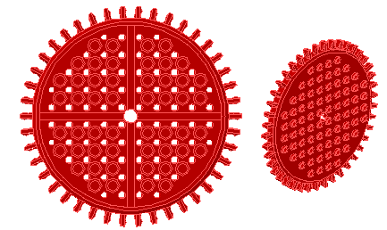

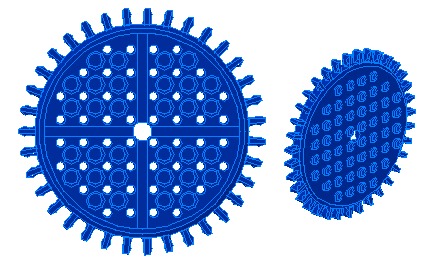

It is a nice machine :sweet: , you will need bigger wheels and strong cylinders. For wheels the 35 or even 42 gear tooth samsonite will fit and for cylinders anyone built with Lego there are big ones and they are stronger. Good luck.
